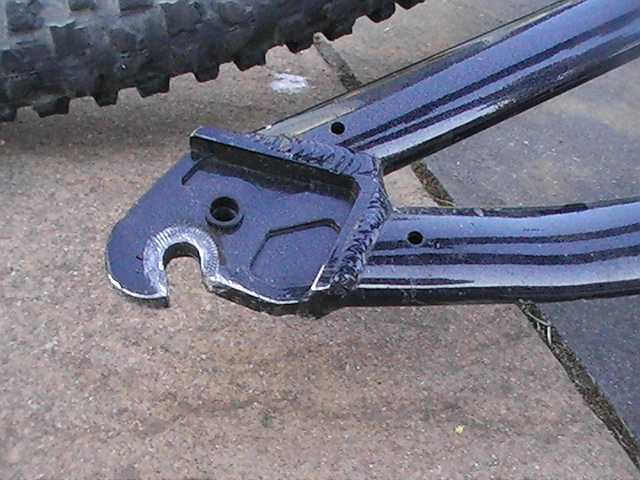

basher Posted June 8, 2007 Report Share Posted June 8, 2007 Thinking of making an adaptor to go on me zenith so can run rear disk as ive got next week off so it something to do. What measurements will i need to take into account. And what shape you think it should be ect a lil drawing would be great, ill put pic of the drop out up. How will ino where the mount holes for the caliper should go is there a way of working it out or is it a case of getting the caliper and disk on and marking it up. Quote Link to comment Share on other sites More sharing options...

basher Posted June 8, 2007 Author Report Share Posted June 8, 2007 This any use to you?Dont think it will work will it because of how the dropout on the zenith is like a reses. Quote Link to comment Share on other sites More sharing options...
RobinJI Posted June 8, 2007 Report Share Posted June 8, 2007 That adapter would die very quickly from trials, as its only supported for forwards breaking.That spec is for an IS front mount, so if you did the same mount on the rear it would work as a +20, which could be nice. Not sure about an actual rear mount though, can't find the spec for it. Quote Link to comment Share on other sites More sharing options...
