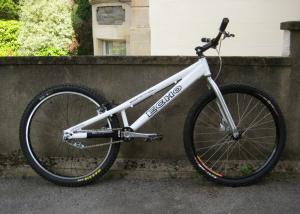

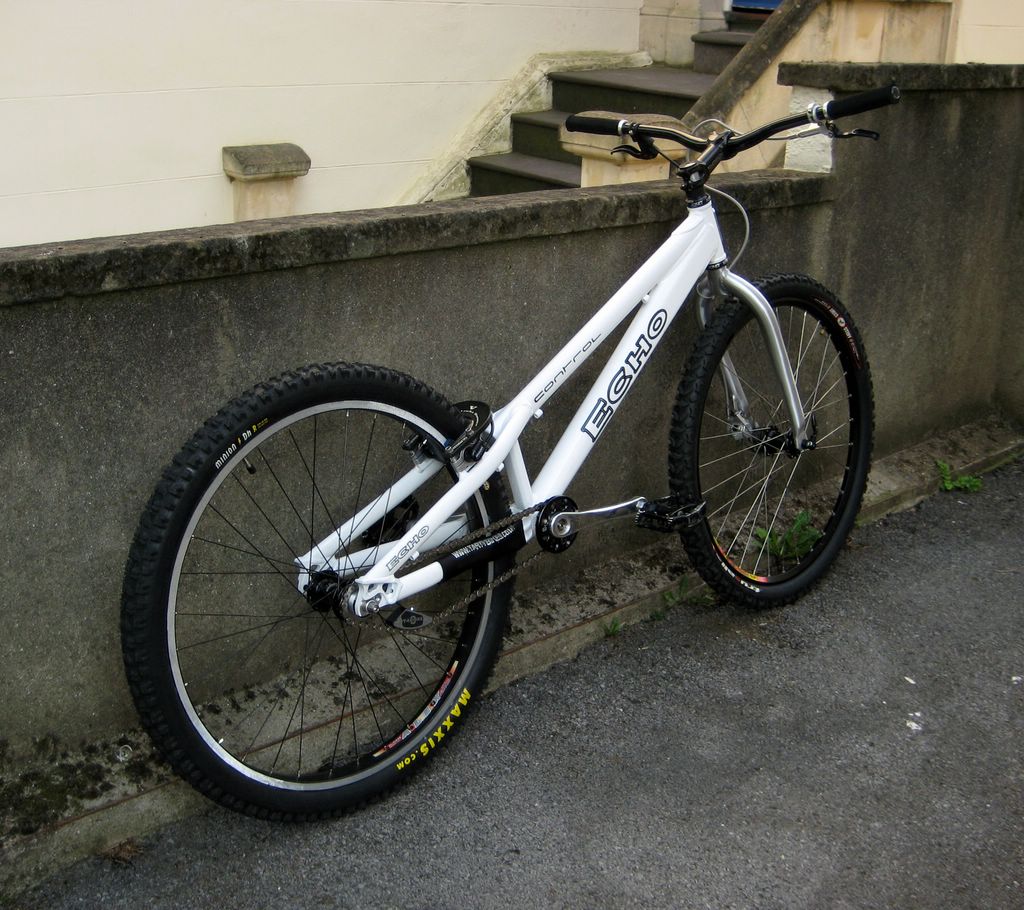

UrbanLegend Posted June 6, 2007 Report Share Posted June 6, 2007 Well, finally finished my stock after a brief period of madness riding mod... So glad to be back on big wheels!Couple of pics first of all...Little spec...'04 Short Control.'07 Urbans.King headset.Original best of the best high rise Zoo bars, Thomson Stem (with 6x Titanium bolts), full Carbon Fibre topcap and spacer, Ritchey WCS Foams.Hope Pro2 front on Mavic X317 Disc rim, Titanium QR, Tryall tyre, Latex tube.Hope Pro2 rear (with Titanium bolts) on Alex DX32, Maxxis Minion Single Ply, with home-made tubeless .HS33 rear, Rock blue's, modified Shimano XTR Carbon booster (the best), Titanium bolts for caliper and lever.Hope Mono Trial front, Titanium rotor and lever bolts.Tensile Urban Legend cranks, modified GU bash to fit, FSA Platinum DH with Titanium crank bolts.Wellgo MG-1 Magnesium pedals.Kool chain, 74Kingz.Total weight: 21.9 pounds complete. Measured at Mud Dock on proper scales, none of this bathroom malarky (bathroom scales indicate 20.5lbs). Pretty damn chuffed with it, few other pimp bits to get like a carbon lever blade etc., but in no hurry as I'm enjoying floating up everything in sight!Comments welcome (no I wouldn't rather black forks )Cheers Quote Link to comment Share on other sites More sharing options...

UrbanLegend Posted June 6, 2007 Author Report Share Posted June 6, 2007 Your bike is 9.9KG, mine is 10.5kg and its a MOD! Well Zona Zip with Onza steel forks and hog wheels.EDIT: Gorgeous btw.Yep, this bike actually weighs less than my 221PR did on the same scales Quote Link to comment Share on other sites More sharing options...

hI-OOPS-CAPS Posted June 7, 2007 Report Share Posted June 7, 2007 can you tell me what you done to the bashring?Im stuck with the tensile dual one so that means a 20t or 22t 5 arm Quote Link to comment Share on other sites More sharing options...
Luke Rainbird Posted June 7, 2007 Report Share Posted June 7, 2007 can you tell me what you done to the bashring?Im stuck with the tensile dual one so that means a 20t or 22t 5 armAngle grinder to the tabs I do believe... Quote Link to comment Share on other sites More sharing options...
streetjibs Posted June 7, 2007 Report Share Posted June 7, 2007 omfg!!!! your bike is gorgeous!!love the white and pimp bits.. ti bolts do make a difference... very nice mate i luv it!!only one thing, and this is being a bit of a willy really.. but i gotta do it,MY BIKES STIL LIGHTER!!! 9.6:P rofl!!! yes on proper scales!! Quote Link to comment Share on other sites More sharing options...
UrbanLegend Posted June 7, 2007 Author Report Share Posted June 7, 2007 Bit of file and dremel action sorted that out. Hassle, but worth it seeing as Tensile UCI bashes are hard to get hold of at the moment. Quote Link to comment Share on other sites More sharing options...

Krisboats Posted June 7, 2007 Report Share Posted June 7, 2007 how do you pinch a front wheel? do elaborate...Generally landing on it with enough force behind it to compress the tyre enough to let the sidewalls of the rim trap the innertube and pierce it. Much in the same way you pinch the rear Looks well nice. Proper smart. Quote Link to comment Share on other sites More sharing options...

manuel Posted June 7, 2007 Report Share Posted June 7, 2007 I love it - its cheating, but i love it....oh and incidentally - the latex matches the colour of his frame on every gap - superb finishing detail. Quote Link to comment Share on other sites More sharing options...
UrbanLegend Posted June 7, 2007 Author Report Share Posted June 7, 2007 Tubeless is so bloody funny, I had literally 8 "punctures" in a row on a silly gap to sharpish concrete, was actually putting small holes in the sidewall of my tyre... Latex pissed everywhere then sealed. Reckon I would have punctured a standard tube a few times (running silly low pressure), but it's so great not having to faff around fixing punctures! Only had issues on lairy gaps, been mint for sidehops and ups etc.I love it - its cheating, but i love it....oh and incidentally - the latex matches the colour of his frame on every gap - superb finishing detail.OH YOU ABSOLUTE BUM!! I thought I would get in before you slammed down your tubeless bashing!! Damn you! At least I can gap forwards Captain Sideways Quote Link to comment Share on other sites More sharing options...
