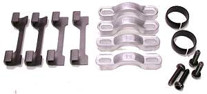

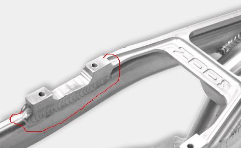

King C Posted June 5, 2007 Report Share Posted June 5, 2007 Why do you "have to braze" them on?To my knowledge the only advantage of brazing is that it looks neater and you can get into tighter places.Im assuming you've seen theseWith the old frame thing Im sure you could just cut a section off around the mounts and weld that to the frame. Cut out a section like this and weld that to the frame.Just make sure you align everything. Quote Link to comment Share on other sites More sharing options...

Radfax Posted June 5, 2007 Author Report Share Posted June 5, 2007 Thanks for that king! them plates which you have pictures, are they avalible on the market to buy? the frame i am thinking of taking the mounts off of is a reefer and they have nice big juicy blocks behind them so give a bit of leaniance with making mistakes! Are you saying that i could use my mig welder to fir these mounts dave! Quote Link to comment Share on other sites More sharing options...
King C Posted June 5, 2007 Report Share Posted June 5, 2007 (edited) they're from CRC. I'll find you a link.EDIT:here palAlthough, they do seem abit flimsy. Not sure how well they'll hold up.Also it says its a braze on kit. Anyone want to shed any light on why they should be brazed instead of welded? Edited June 5, 2007 by kcchan Quote Link to comment Share on other sites More sharing options...

dave85 Posted June 5, 2007 Report Share Posted June 5, 2007 The braze on kit that you can get from CRC is just that, for brazing (or welding) to steel frames. Quote Link to comment Share on other sites More sharing options...

Christophe' Posted June 5, 2007 Report Share Posted June 5, 2007 The braze on kit that you can get from CRC is just that, for brazing (or welding) to steel frames.listen to him!And they aint flimsey! Quote Link to comment Share on other sites More sharing options...

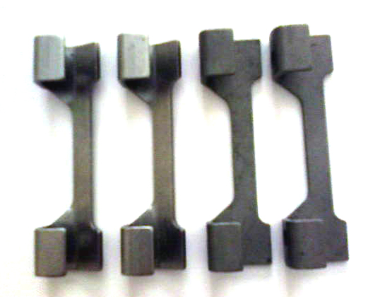

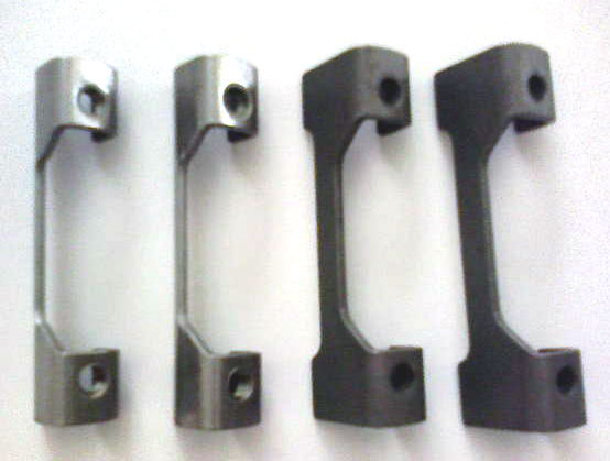

powerz Posted June 6, 2007 Report Share Posted June 6, 2007 (edited) I have these if they are any use to you never used em just been sitting in me box of bike bits. £4 posted Edited June 6, 2007 by powerz Quote Link to comment Share on other sites More sharing options...
Guest Posted June 6, 2007 Report Share Posted June 6, 2007 as has allready been said those are for brazing or welding onto steel frames. His frame is not steelIf you have access to heat treatment then definately get it done without a doubt. it'll be a learning experiance if nothing else. Quote Link to comment Share on other sites More sharing options...
powerz Posted June 6, 2007 Report Share Posted June 6, 2007 (edited) O.K cool just trying to help out but yea i hadnt read the full post sorry. Edited June 6, 2007 by powerz Quote Link to comment Share on other sites More sharing options...
