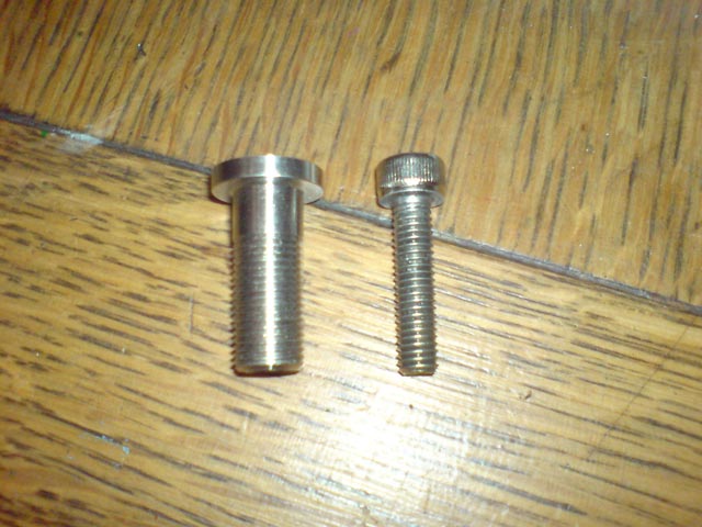

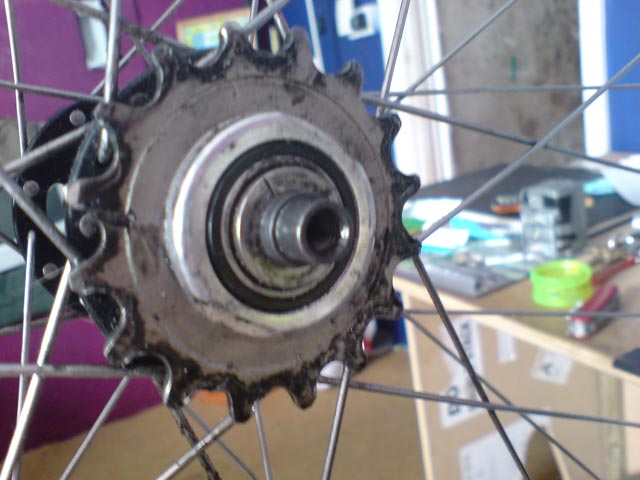

fyfey Posted June 5, 2007 Report Share Posted June 5, 2007 I have a front Zoo! hub and a rear one (20" spacing). I was tightening the rear bolts up and one of the heads of the bolts sheared off!I ordered a set of the Echo/Zoo/Adamant etc bolts off TartyBikes. I didn't think to check but the bolts in the rear hub are much thinner than the ones in the front. My mate has an Echo rear hub on his stock and they use the beefy bolts... is it just the 20" ones that use these flimsy bolts??If so, which bolts do I need? Is there a way to make the larger hollow bolts to work on the rear hub?Cheers,Fyfey Quote Link to comment Share on other sites More sharing options...

fyfey Posted June 5, 2007 Author Report Share Posted June 5, 2007 It's practically a brand new hub, pretty annoying paying £75 for a hub that has the "old" style axle. Here's a couple of pics...Bolts:Hub:Is there any way to change the axle to a beefier one? The M6 bolts look puny compared! Quote Link to comment Share on other sites More sharing options...
RobinJI Posted June 5, 2007 Report Share Posted June 5, 2007 Not that I know of. To be fair the bolts are fine. I've been running them for ages in my 24" with horizontals, and the wheel never moves or anything. Just do them up sensibly. Quote Link to comment Share on other sites More sharing options...
powerz Posted June 5, 2007 Report Share Posted June 5, 2007 (edited) I had the same prob my bolt snaped right of in the hub so after removing it i ordered the ones from tarty for like £6 then got em through and they were far to big,after ringing tarty they said "send em back and you just need the standard onza type bolts as your hub is one of the rare ones" our hubs axle stick through the frames dropouts where as the other style axle the beafy bolts sit through the frame dropouts if you know what i mean.think you will find these are what will fit http://www.tartybikes.co.uk/product.php?id=10057I thought the same thing that paying £75 for a hub and you get the socal rare one or inother words one of the duff ones is annouying as i keep rounding the stupid lil bolts of and snapping em half in the hub.i brought the onza ones from tarty and the next day one bolt sheared of in the huband the other bolt showed signs of stretching in the same place. so i browsed through screwfixit and brought 50 for like £3 Edited June 5, 2007 by powerz Quote Link to comment Share on other sites More sharing options...
RobinJI Posted June 5, 2007 Report Share Posted June 5, 2007 Yeah, the ones that come with the onza things are utter shite, made of cheese. Just get them for the serated washer, and buy yourself some high grade stainless M6 bolts to go in there. Quote Link to comment Share on other sites More sharing options...
Waddy Posted June 5, 2007 Report Share Posted June 5, 2007 Yeah, the ones that come with the onza things are utter shite, made of cheese. Just get them for the serated washer, and buy yourself some high grade stainless M6 bolts to go in there. my stainless ones bent , iv got some high tensile steel ones now (black ones) from my local nut and bolt supplier, and there beasts, can get them mega tight, and the hex head is still like new, proper hard steel and were only 40p each Quote Link to comment Share on other sites More sharing options...
fyfey Posted June 5, 2007 Author Report Share Posted June 5, 2007 Would Titanium bolts be any better do you think? Surely better than the Onza bolts anyway.There's some on Tarty for £9 a pair, I might give them a go - LinkCheers for the input Quote Link to comment Share on other sites More sharing options...
