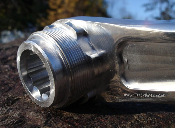

Token Posted May 22, 2007 Report Share Posted May 22, 2007 I could post this is in the Angry Thread but.... I need abit of feedback.I bought some Tensile cranks, with eno and BB off someone on here. They were described as fine, perfectly working. Now somehow, this guy managed to post these bits to somebody else. 2 weeks later of chasing up where they ended up and I managed to pick them up. Wicked, so the non-driveside pedal thread is screwed up, order one from Supercycles and they manage to delay that process by another 11 days. So here I am, today. Cranks are on, pedal thread is in. Pedals are ok-go. Yay I can finally get out on the bike after 3 weeks...So my first gap on this setup and it feels like the wheel is slipping, no traction. So I go for it again, and it happens again I'm just not going anywhere. Ofcourse I check it out and notice that I can turn the cranks round without the freewheel moving (the chain and freewheel stay stationery, but both cranks an bb move round) so it looks to me as if the freewheel or the crank threads have been threaded. Now I hope some of you can see how justifyingly furious I am 3 weeks of waiting, lies and just stupid cockups and a pretty much brand new bike that I can't ride. Tomorrow I'll go down to halfords and make free use of their tools to take the freewheel off and actually see whether the crank or the freewheel is getting threaded.The question: If the cranks are threaded, can I get a free or half price replacement? Obviously if the freewheel has threaded then I'll need a new inner ring. I'm praying that both haven't threaded. God I feel like I've been so ripped off I want to cry. one very unhappy mat. Quote Link to comment Share on other sites More sharing options...

Mark W Posted May 22, 2007 Report Share Posted May 22, 2007 The threads on the crank would go before the freewheel, so I have a feeling you're shit out of luck. You should be able to get a crash replacement though... Quote Link to comment Share on other sites More sharing options...

Ben@LeicesterTrials Posted May 22, 2007 Report Share Posted May 22, 2007 Exact same thing happend to me, threads on tensile cranks had gone, cog was perfect though, i know how you feel though i felt f**king gutted and just thought to my self why do i bother, its a twat i know! Quote Link to comment Share on other sites More sharing options...

Gaz M Posted May 22, 2007 Report Share Posted May 22, 2007 how many times did you try the gap? if you only put weight on the pedals for a few seconds it could jsut be the freewheel tightening upto the cranks, but that should go away after like doing 3 decent gaps Quote Link to comment Share on other sites More sharing options...
Token Posted May 22, 2007 Author Report Share Posted May 22, 2007 Well I tried the gap twice, realised there was something wrong and now I can literally put pressure on the cranks and they will turn round, and the freewheel will stay totally stationary. Quote Link to comment Share on other sites More sharing options...

dave85 Posted May 22, 2007 Report Share Posted May 22, 2007 How thick is that bashplate, does it fit on the splines (do your cranks even have bashplate splines?), and can you remember how much thread was showing when you screwed the freewheel on? Quote Link to comment Share on other sites More sharing options...
Token Posted May 22, 2007 Author Report Share Posted May 22, 2007 Well as I said, I've only just bought these cranks, this is literally my first time riding them. Ofcourse they were all put together by the guy I bought them off so I guess he could be to blame, or either that, tensile metal is like a soft shropshire brie cheese. I just can't believe it's happened.P.s the bashplate is approx 4mm thick, if that has anything to do with it. It moves with the crank, when the freewheel stays still so I'm pretty sure it does have splines otherwise the cranks would turn an the freewheel an bash would stay together. Quote Link to comment Share on other sites More sharing options...

dave85 Posted May 23, 2007 Report Share Posted May 23, 2007 There are two designs of tensiles, the splined bash ones (the UCI version)and normal ones, imagine that picture with the threads extending all the way up to the arm. On the first tensiles, the thread was very long and you could safely get a bashring on before the freewheel. Without a bashring, the freewheel screwed too far on and instead of tightening down on the arm as it should, it tightened down on the end of the threads. So they included a machined plain section (seen in the pic above). The UCI cranks have a spline to take a 5mm (I think) thick bashring, and still leave enough thread to hold the freewheel. My guess is your bashring has taken up too many threads, leaving the freewheel hanging on by probably only 6 or 8 mil. You'll more than likely have stripped the crank, freewheels are tough beasts so that should've survived. Quote Link to comment Share on other sites More sharing options...
domonza Posted May 23, 2007 Report Share Posted May 23, 2007 Are you using the black tensile bash, if so when you screw the freewheel on it hasent got enough threads to grip onto, so just take the bash of and just screw the freewheel right on and that should sought it. Dom Quote Link to comment Share on other sites More sharing options...
Mike Poyzer @ Onza Posted May 23, 2007 Report Share Posted May 23, 2007 The original Tensiles with long thread were designed to take a straight through freewheel and would not take an ACS/ Shimano etc because it was too long. The cranks were then modified with a step at the end of the thread to take this type of freewheel. They were never intended to take a bash as well and if so used there would be inadequate thread length and the threads would certainly be prone to stripping. The UCI version is designed to take a bash plate on the splines and still adequately hold a freewheel.We certainly stand by our half price replacement policy despite the fact that you patently do not qualify. When you call me with such a problem in the future , by the way, I would recommend that you tell me the whole truth. Tensile products are premium products and our warranty is second to none. We are certainly more sympathetic to customers who do not try to bullshit us. Being economical with the facts does not usually work as the truth usually comes out. Quote Link to comment Share on other sites More sharing options...
