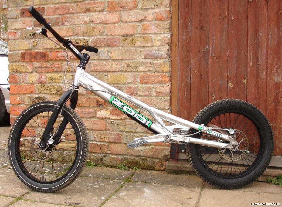

Yeh its not too hard, as long as you can work a file and a saw.
Get a large piece of aluminium, about 6mm thick at least.
Drill a hole for the rear axle, mount it in your frame, bend the top which will fit onto the four bolt mount, mark and drill that, the mount the disc rotor on the wheel, mark and drill the holes for the caliper, and then get drilling and filing to make it lighter.
Found this pic on my comp, its not the best pic but shows what you are looking at making, but remember that caliper has to be within 1mm vertically of where it should be and exactly where it should be on the horizontal, the pads only move about a quarter of a millimetre.
There was a DD GU in bike pics a while back, I'll have a search to see if I can spot it.
EDIT: Here's the link. If you are going to go DD, get used to trueing wheels, my mate has had a DD monty for about 6 months, he has had a new set of wheels and I have already had to tension and true them twice.
http://www.trials-forum.co.uk/forum/index....;hl=Double+Disc

You don't weld tabs onto the piece of aluminium, you file and drill them out of it. The mount on the GU is just a single piece of ali, bent a bit, filed a bit and drilled a bit. There is no welding neccessary.
Unless you decided to get it welded up profesionally of course, I know that you can get mounts welded to frames.
