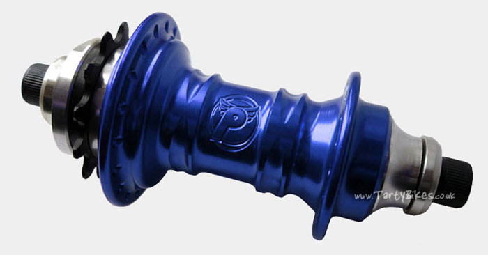

kid creole Posted April 21, 2007 Author Report Share Posted April 21, 2007 I'm not gonna buy a profile *** it up thats stupid !!! they cost about £140. I mean something like this but in 36 hole http://www.tartybikes.co.uk/product.php?id=411 . i already am using a dmr revolver but as the sprocket screws on to a thread theres no way of adjusting the chain line with my front freewheel which is the problem I'm having , so if i was to have a hub like the one in the link id be able to adjust it. I only called it a fixed cassette hub as it does have a cassette body its just fixed so seems an appropriate name. Quote Link to comment Share on other sites More sharing options...

RobinJI Posted April 21, 2007 Report Share Posted April 21, 2007 If you mean this hub then it is definatly fixed Quote Link to comment Share on other sites More sharing options...
kid creole Posted April 21, 2007 Author Report Share Posted April 21, 2007 yeah that one cause it comes in 36 holes too Quote Link to comment Share on other sites More sharing options...
