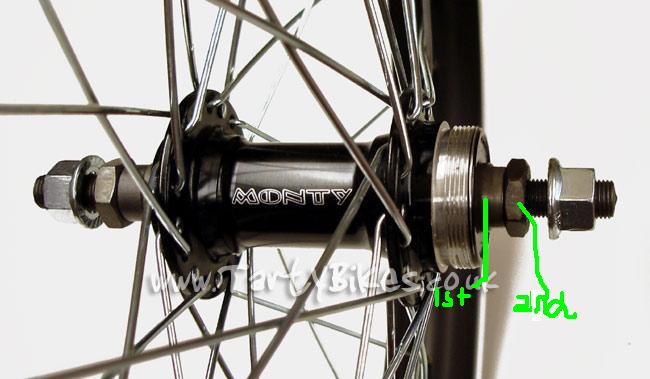

Louth Trials Posted April 16, 2007 Report Share Posted April 16, 2007 you need either a cone spanner or a normal spanner that fits.fistly undo your wheel nuts,then get your cone spanner or normal spanner and tighten the nut like things. (1st step)(see pic)**not too tight so that they don't wobble any more and so that your wheel still spins freely**then the 2nd step in the pic tighten these up to stop the cones from coming loose again.repeat this on the other side,then put your wheel in the correct position and tight the wheel nuts up again.hope i have helped... Quote Link to comment Share on other sites More sharing options...
Anjow Posted April 16, 2007 Author Report Share Posted April 16, 2007 Yes, that's very helpful thanks. Do I need to take the wheel out to do this? Quote Link to comment Share on other sites More sharing options...

ScotchDave Posted April 16, 2007 Report Share Posted April 16, 2007 (edited) If you can tell us what hub you have, and/or take a picture of it we would be able to help you a lot more. Edited April 16, 2007 by ScotchDave Quote Link to comment Share on other sites More sharing options...
Louth Trials Posted April 16, 2007 Report Share Posted April 16, 2007 Yes, that's very helpful thanks. Do I need to take the wheel out to do this?you do not have to take the wheel out to do this but just loosen the nuts off,but if you feel it easier take the wheel out... Quote Link to comment Share on other sites More sharing options...
RicH_87 Posted April 16, 2007 Report Share Posted April 16, 2007 you don't have to take the wheel out no, just loosen the bolts.just try and get two spanners that fit, put on on each side then turn them very gently in opposite directions until you feel a little resistance.don't proper whack on the force and tighten them like hub bolts, they just need to be tight enough to keep the wheel straight (no wobble), but still loose enough for the wheel to spin freely and smoothly.tighten the hub bolts and spin the wheel with your hand when you are done, if it stops pretty much straight away you have probably tightened them too much.oh, and don't expect them to last for a long time, un-sealed hubs almost always screw up eventually. just keep them tight and check it regularly though and it'll be fine for a good few months. Quote Link to comment Share on other sites More sharing options...
Anjow Posted April 16, 2007 Author Report Share Posted April 16, 2007 What's happened:I felt the chain and it was a bit too loose as well. I did take the wheel out, it took a bit of thinking for me to figure out how everything fit together so I could remember to put it back right. I then found out my adjustable spanners were too thick, but both my pedal spanners were almost exactly right for adjusting the cones. So I tightened them up so that it didn't wobble, but didn't feel like there was gravel in the wheel either, then tightened their retaining nuts. That was pretty hard because when I was tightening the retaining nuts they kept rubbing on the cones and making them tighter. I got it in the end. I put the wheel back on, struggled a bit to fit the chain tensioners but managed in the end, phoned a friend about chain tension and got that sorted. Finally I stuck the brakes back on and adjusted them and...... I'm now left with a bike where the wheel doesn't wobble and the chain isn't too lose.Thanks for the help, it isn't as scary as I thought it would be. Quote Link to comment Share on other sites More sharing options...
