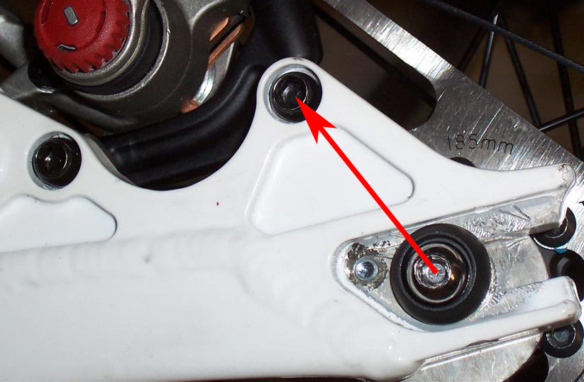

PaRtZ Posted April 14, 2007 Report Share Posted April 14, 2007 as youre probably aware fred savage was kind enough to furnish me with a lovely this lovely new frame. Well heres why you have no pictures of me riding it80% of the reason i bought it was to run rear disc. So i thought I could just swap bits over from my dual disc megamo over to it... So i plonked my wheel in and it was too narrow. well im sure it was an odd sized hub (bikegas hub) so i bought a brand new one from tarty (monty hub) fits fine however when it comes to the disc the only thing that comes to mind is "wtf" . seriously no jokeFor a start theres no customisation with the chain length, because at the very back of the dropout the disc (when mounted) does not have 100% contact with the pads, meaning when the brake is applied, the pads form a pyramid shape. The answer is the move the wheel back in the dropout but like I said, thats when the wheel is right at the back.this was using a 160mm mono trial. So i thought maybe im being silly, and besides i much prefer mechanical disc brakes so again, i splashed out on a new avid 185mm BB7 thinking the extra 5mm is what I needed. Again, I was wrong, even after removing some washers to bring the caliper lower, its still about 3-4mm too high, forming this pyramid shape. So as you can imagine im a bit annoyed. I was having a problem with the spacing in the dropout too, but I think I ca sort that anyway, and probably it being a monty hub its too narrow anyway so thats easy to do, but Im still 100% baffled as to what I have to do to solve the pyramid-shape-pad-problem. Obviously the extreme aswer is to get a custom mounting bracket machined, but surely it should be made to make standard disc brakes? so im a bit peeved to be honest. £600 and I still don't have a bikeAny answers or suggestions no matter how dodgy/bodgy will be appreciated. Thanks in advance Quote Link to comment Share on other sites More sharing options...

PaRtZ Posted April 14, 2007 Author Report Share Posted April 14, 2007 (edited) Yeah ill get some pictures now adam, its 18:12 the chain is quite new (so will stretch bringing the disc even further out))EDIT: some pictures here: Edited April 14, 2007 by PaRtZ Quote Link to comment Share on other sites More sharing options...
AdamR28 Posted April 14, 2007 Report Share Posted April 14, 2007 Hmm, the disc/rotor contact area looks ok with that Avid. I take it the Mono Trial was worse?When you say 'forms a pyramid', I can't quite work out what you mean there... any chance of a diagram?Cheers again Quote Link to comment Share on other sites More sharing options...

PaRtZ Posted April 14, 2007 Author Report Share Posted April 14, 2007 best i can do Quote Link to comment Share on other sites More sharing options...

Tomm Posted April 14, 2007 Report Share Posted April 14, 2007 I see what you're saying but from this picture the pads look spot on? How come you got it early? Is it some pre-production model or something? Quote Link to comment Share on other sites More sharing options...

AdamR28 Posted April 15, 2007 Report Share Posted April 15, 2007 How exactly do they expect you do ajust the chain but the calliper not move with the position that it's in?With a standard mod bike gear ratio (which 99% of people run anyway), the stays always come out to 362-363mm length, that 1mm isn't enough to upset the brake rotor. It works great on Montys after all Matt - have a look here: http://www.hayesdiscbrake.com/pdf/Rear%20QR%20IS.pdf and check the mounting holes are in the correct position on your frame.As Tomm said, it looks like the brake is spot on from the picture he quoted, but the alignment looks a bit squiff from another picture you posted. Is it definitely set up well? Any chance of a pic looking along the line of the rotor too? Quote Link to comment Share on other sites More sharing options...
PaRtZ Posted April 15, 2007 Author Report Share Posted April 15, 2007 (edited) ok all is sorted. Big thanks to will for thisThe answer is that the disc tab is already +20mm. meaning you can't run a 160mm rotor but you have to run a 160 caliper on a 185mm rotor because the caliper already has this +20mm from the frameWill got his 160mm (well a 185mm front which translates....yeah i wont confuse you) and we put it on the back to give us the 160mm caliper and it worked. We had room for movement too chain is now a normal length (dave the khe is back on) But we still had a problem...For some reason koxx have a MASSIVE weld on the chainstay/dropouts join meaning theres a big bulge on it....meaning the bracket cant sit flush on the dropout because this weld is on the way (its in contact with the bit which has the bolt thread in it, for the caliper to screw into) So we packed it out and needless to say, it was rubbing on the outside pad. Anyway a bit of b*****d filing later and it was good. Very very very close fit but a fit none the lessso a warning to anyone getting one. You have to run a 160mm mono trial and unless they've changed the design of the hopes, be prepared to fork out for a 180mm rotorWill post some pictures in the bike pictures section today. I sliced my finger open a bit so ive got a large bandage on so no silly drop gaps. also need to bed bb7 in but otherwise all good EDIT: ooop also snapped a tooth off my eno, any suggestions? Edited April 15, 2007 by PaRtZ Quote Link to comment Share on other sites More sharing options...
