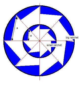

mafu26 Posted January 6, 2008 Report Share Posted January 6, 2008 Quote No matter how far out on the radius of the sprocket the rachet is positioned aslong as there are the same amount of rachets the crank would have to turn the same distance because the angle the crank turns though = 360 divided by no. of engagementsi don't think thats completely correct... if you increase the size of the radius of the ratchet and still keep the same amount of teeth the distance between each tooth will increase. so that means you will have to move the crank further for it to engage. i think i'm right by saying if you double the radius if the ratchet you would have to double the amount of teeth for the crank to move the same distance on the orginal ratchet for it to engage. thats why its more accurate to use radians rather than degrees because radians is a measure of radius over angle swept. i might be taking complete rubbish though so feel free to prove me wrong. Quote Link to comment Share on other sites More sharing options...
Muel Posted January 6, 2008 Report Share Posted January 6, 2008 mafu26 said: i don't think thats completely correct... if you increase the size of the radius of the ratchet and still keep the same amount of teeth the distance between each tooth will increase. so that means you will have to move the crank further for it to engage. i think i'm right by saying if you double the radius if the ratchet you would have to double the amount of teeth for the crank to move the same distance on the orginal ratchet for it to engage. thats why its more accurate to use radians rather than degrees because radians is a measure of radius over angle swept. i might be taking complete rubbish though so feel free to prove me wrong.No it doesn't, if you increase the rachet, thus increasing the tooth size, it doesn't make any difference to how far you move the crank arm, because the crank arm rotates, so you move it through 360/36= 10 degrees for every engagement.The freewheel itself can be any size, because it engages 36 times per rotation. Quote Link to comment Share on other sites More sharing options...
mafu26 Posted January 6, 2008 Report Share Posted January 6, 2008 (edited) ok i've drawn a pic to show what i mean. if you look at the blue teeth on the inside of the ratchet (8 for simplicity) and there's a black line, a indicating how far the pawl has to travel along the ratchet tooth before it engages again. each freewheel has the same number teeth inside the ratchet but if you can see the bigger one has to travel further for it to engage. do you see what i mean? Edited January 6, 2008 by mafu26 Quote Link to comment Share on other sites More sharing options...
AdamR28 Posted January 6, 2008 Report Share Posted January 6, 2008 it does have to travel further in actual distance, but its the same in degrees. Quote Link to comment Share on other sites More sharing options...
boon racoon Posted January 6, 2008 Report Share Posted January 6, 2008 mafu26 said: ok i've drawn a pic to show what i mean. if you look at the blue teeth on the inside of the ratchet (8 for simplicity) and there's a black line, a indicating how far the pawl has to travel along the ratchet tooth before it engages again. each freewheel has the same number teeth inside the ratchet but if you can see the bigger one has to travel further for it to engage. do you see what i mean?mat's designing a wheelchair that's capable of taking steven hawking to the top of a mountain. he knows his shit. Quote Link to comment Share on other sites More sharing options...
toxicturky Posted January 6, 2008 Report Share Posted January 6, 2008 (edited) yeah, as far as your foots concerned at the end of the crank arm, it doesnt make any difference, the smaller diameter ratchet would surely need to be stronger 'cos it's got more leverage on the teeth?providing both large and small ratchets have the same number of engagements yada yada yada Edited January 6, 2008 by toxicturky Quote Link to comment Share on other sites More sharing options...
mafu26 Posted January 7, 2008 Report Share Posted January 7, 2008 ahhh. i give up Quote Link to comment Share on other sites More sharing options...
Adam-Griffin Posted January 7, 2008 Report Share Posted January 7, 2008 16T Freewheel=Sexy time Quote Link to comment Share on other sites More sharing options...

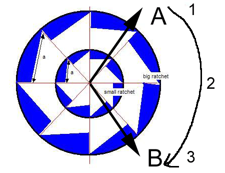

AdamR28 Posted January 7, 2008 Report Share Posted January 7, 2008 Black arrow = crank arm.If you go from Position A to position B you get 1, 2, 3 clicks on both ratchets. Quote Link to comment Share on other sites More sharing options...

mafu26 Posted January 7, 2008 Report Share Posted January 7, 2008 (edited) urg i dunno. confused now good bit of banter thoughedit: yeah i'm talking rubbish. think i'm confusing it with if your crank arm was longer then you'd have to move your leg more...? Edited January 7, 2008 by mafu26 Quote Link to comment Share on other sites More sharing options...
Dan6061 Posted January 9, 2008 Report Share Posted January 9, 2008 I see your theory...but Adam's right. Quote Link to comment Share on other sites More sharing options...
