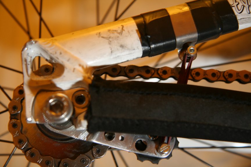

Ali C Posted December 16, 2007 Report Share Posted December 16, 2007 just made mine by bodging the slider off a 74 kings and cutting a sheet of 1.8mm carbon. The carbon is held in place by the hub bolt and is pushed against the chain, the 74 kings part flexes creating a sprung tensioner. I made the carbon the shape to stay within the frame as much as poss. Its REALLY stiff carbon, so I have no bending or strengh worries.The whole thing weighs 14g.*needs the main hub mount drilling to 10mm before anyone says. I'll get a pic when its on the bike (if it works) Quote Link to comment Share on other sites More sharing options...

Ali C Posted December 16, 2007 Report Share Posted December 16, 2007 it seems to have more than enough spring. Quote Link to comment Share on other sites More sharing options...
toyota200x Posted December 16, 2007 Report Share Posted December 16, 2007 2sixstreetHow is that tensioner able to pivot if it is getting pinched between the frame and hub? I want to make one like this, but I have a QR Chris King. Quote Link to comment Share on other sites More sharing options...
JonMack Posted December 16, 2007 Report Share Posted December 16, 2007 2sixstreetHow is that tensioner able to pivot if it is getting pinched between the frame and hub? I want to make one like this, but I have a QR Chris King.It doesnt. You put it on before you tighten the wheel up, allowing it to tension, then tighten it up, and it all stays nice. Quote Link to comment Share on other sites More sharing options...
James Quigley Posted December 16, 2007 Report Share Posted December 16, 2007 will the 74kingz part not rotate around the bolt under pressure? Quote Link to comment Share on other sites More sharing options...
2sixstreet Posted December 23, 2007 Report Share Posted December 23, 2007 2sixstreetHow is that tensioner able to pivot if it is getting pinched between the frame and hub? I want to make one like this, but I have a QR Chris King.Sorry for late reply, am currently down under lapping up the sunshine...The hole in the arm is big enough to rotate freely around the end of the hub right next to the cassette lockring. It doesnt get pinched at all. The spring does all the tensioning. Quote Link to comment Share on other sites More sharing options...

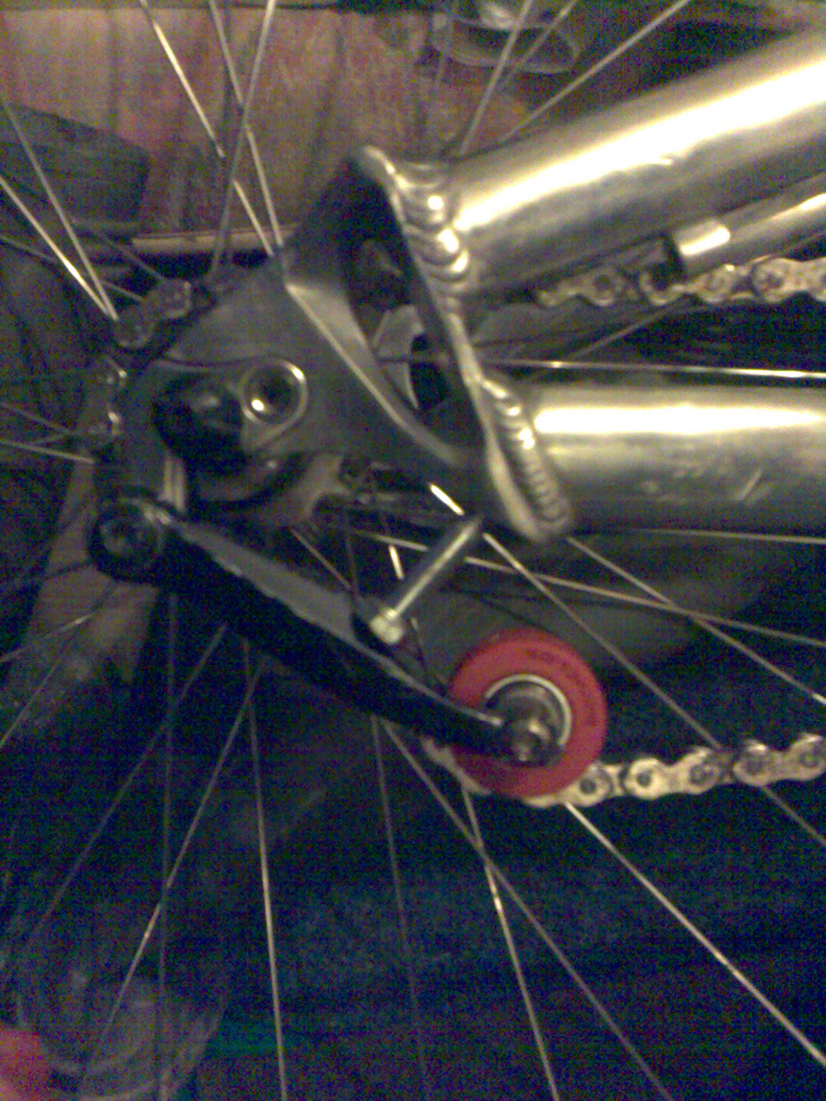

Mowgli Posted January 5, 2008 Report Share Posted January 5, 2008 Dont need carbon fibre!here are a couple of pics of my attempt, works well so far. Same design as kennards as i copied him, hehe .hopefully now i wont be scared of learning side hops because it doesnt matter if i snap the mech hanger. Quote Link to comment Share on other sites More sharing options...

Alex Dark Posted January 21, 2008 Report Share Posted January 21, 2008 Heres mine: Made from: cheapo bike suspension pivot bolt, dmr roller, promax vee arm (with spring removed) Quote Link to comment Share on other sites More sharing options...

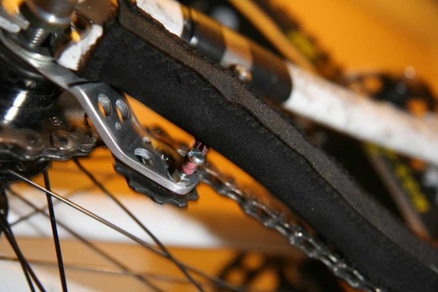

2sixstreet Posted February 21, 2008 Report Share Posted February 21, 2008 Variation on my previous one. Have replaced the spring with a rubber band kindly left by Royal Mail. Test ride this afternoon was successful. Quote Link to comment Share on other sites More sharing options...
