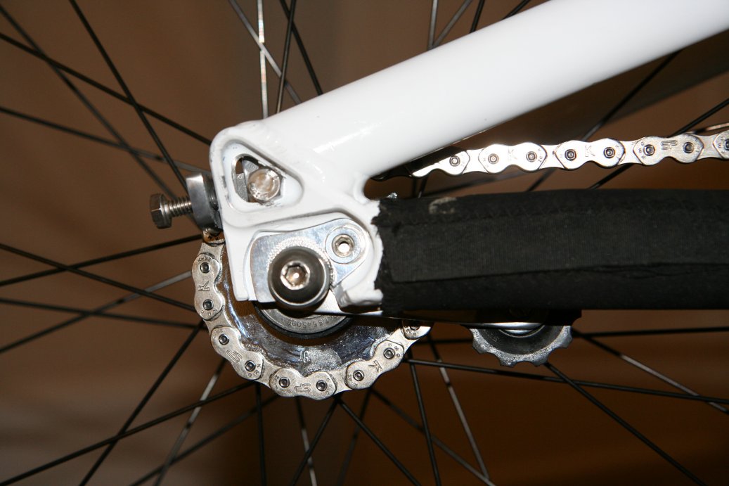

Bigman Posted August 14, 2007 Report Share Posted August 14, 2007 Here's mine, still working after 9months.....Just rubbing it in abit Adam Quote Link to comment Share on other sites More sharing options...
Luke Rainbird Posted August 14, 2007 Report Share Posted August 14, 2007 Yeah, but Bigman, yours is so lanky May as well mount it behind the BB as opposed to the dropout! Quote Link to comment Share on other sites More sharing options...

Krisboats Posted August 15, 2007 Report Share Posted August 15, 2007 (edited) Okay, i'm halfway through making a kennard/bigman style tensioner.... only i've come into some problems trying to drill the holes into the metal. Anyone got any idea what drill bit i need in order to drill it easier, becuase its taking ages just to make a little dimple in the metal ?Like a dog returning to its own vomit i've gone and made ANOTHER one. The 4th posted in this thread. This one is to suit pro2. Its a 2 piece with adjustment. The idea is borrowed from the b tension arrangement on rear mechs.That one is the perfect trials tensioner. Completely out the way, gives fantastic wrap around... now you just need to experiment with different cog sizes and alignment setups and get it marketed. I can see this being a VERY popular style of tensioner. Edited August 15, 2007 by Krisboats Quote Link to comment Share on other sites More sharing options...

Krisboats Posted August 16, 2007 Report Share Posted August 16, 2007 Okay, its all been drilled now.... after lots of hard work and many snapped drill bits.Here's some pics of it Built together before i got the metal neatened up.Some tidyingAttached to the bikeSeems to do the job so far. I can kick it really hard and it just pushes up and returns to place as soon as my foot comes off it. Just need to neaten it up, trim the bolts and sray paint the end sections black. Quote Link to comment Share on other sites More sharing options...
