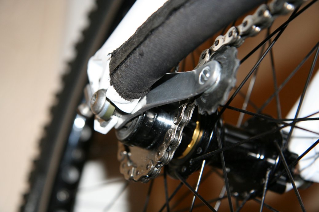

BenLeacock™ Posted June 21, 2007 Report Share Posted June 21, 2007 I've gone and made another one. Have only ridden a few minutes on it to test it but initial results are promising.that looks really cool. I like the original one u made ash Quote Link to comment Share on other sites More sharing options...

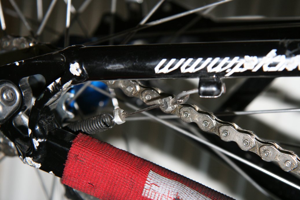

Fixed Pants™ Posted June 21, 2007 Report Share Posted June 21, 2007 Bodged up derailleur f**k, can't find pics of it atm, will get some later though. Quote Link to comment Share on other sites More sharing options...
Joe Sheehan! Posted June 21, 2007 Report Share Posted June 21, 2007 How does that spring attach to the frame? Closer pic? Quote Link to comment Share on other sites More sharing options...
2sixstreet Posted June 21, 2007 Report Share Posted June 21, 2007 How does that spring attach to the frame? Closer pic?The spring hooks into the cable guide on the frame so its not for everyone... Not required if the friction on your quick release/fun bolt is substantial. Quote Link to comment Share on other sites More sharing options...
Joe Sheehan! Posted June 21, 2007 Report Share Posted June 21, 2007 Pretty good, and thats a bent nail in the guide? Quote Link to comment Share on other sites More sharing options...

Ash-Kennard Posted June 22, 2007 Author Report Share Posted June 22, 2007 The spring hooks into the cable guide on the frame so its not for everyone... Not required if the friction on your quick release/fun bolt is substantial.^^^ ooo thats an awesome idea. Quote Link to comment Share on other sites More sharing options...

King C Posted June 26, 2007 Report Share Posted June 26, 2007 Have you tried it yet. From what I can see in the picture I think the chains going to wear into the tape and surely the whole thing will just fall apart, unless theres something I cant see. Quote Link to comment Share on other sites More sharing options...
Muel Posted June 26, 2007 Report Share Posted June 26, 2007 Lovely!LMAO Matt, is that jsut bash plate rubber?! Well done, nice and functional! Quote Link to comment Share on other sites More sharing options...
Matthew_Gibson Posted June 26, 2007 Report Share Posted June 26, 2007 Have you tried it yet. From what I can see in the picture I think the chains going to wear into the tape and surely the whole thing will just fall apart, unless theres something I cant see.I have yes, It stay in place well. not 100% of the time. need to work on that! and the only thing else thats holding it in place is a few ziptiesLMAO Matt, is that jsut bash plate rubber?! Well done, nice and functional!Yes, it is indeed! Got bored. There is a half link in the chain that helps. Quote Link to comment Share on other sites More sharing options...

2sixstreet Posted June 28, 2007 Report Share Posted June 28, 2007 Am i the one of the very few people who have made a my own tensioner and that still has it working? mine is working still and beautifully at that! have to say that it is the bets thing i have ever made for my bike!AdamThe 3 i've made work a treat. This is the latest configuration. I keep making them because I find simpler ways of doing it. This is a keeper. Now complete with blanking replaceable dropout plate. Quote Link to comment Share on other sites More sharing options...
basher Posted June 28, 2007 Report Share Posted June 28, 2007 Where did you get the spring from? Quote Link to comment Share on other sites More sharing options...
manuel Posted June 28, 2007 Report Share Posted June 28, 2007 how is the arm on that free to move ? isnt it clamped by the axle ? im guessing the only way you could of done it would be to fit it over the axle ? in that case i would be worried of it catching the freehub body and giving me some pain... Quote Link to comment Share on other sites More sharing options...
basher Posted June 28, 2007 Report Share Posted June 28, 2007 (edited) how is the arm on that free to move ? isnt it clamped by the axle ? im guessing the only way you could of done it would be to fit it over the axle ? in that case i would be worried of it catching the freehub body and giving me some pain...It isn't but im guessing that it just works like a fixed tensioner apart from that when the tensioner trys to move like they always do the spring will hold it in place. Keeping the tension.I may try making one the same but with a pivot half way. Edited June 28, 2007 by andy h Quote Link to comment Share on other sites More sharing options...
2sixstreet Posted June 28, 2007 Report Share Posted June 28, 2007 It isn't but im guessing that it just works like a fixed tensioner apart from that when the tensioner trys to move like they always do the spring will hold it in place. Keeping the tension.I may try making one the same but with a pivot half way.The spring is from a dead sora mechThe arm fits over the axle and is free to move. There is no way it will ever get snagged. Check it out next time I see you out Rowan and decide for yourself. A pivot half way isnt necessary. The spring is essential to hold the tension in this version. If I go to a frame with no cable guide then i'll make a clamp to suit the seat stay. You can set the tension by the length of the cable holding the spring but it doesnt need much to hold it. Quote Link to comment Share on other sites More sharing options...

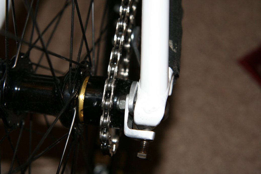

2sixstreet Posted August 14, 2007 Report Share Posted August 14, 2007 Like a dog returning to its own vomit i've gone and made ANOTHER one. The 4th posted in this thread. This one is to suit pro2. Its a 2 piece with adjustment. The idea is borrowed from the b tension arrangement on rear mechs. Quote Link to comment Share on other sites More sharing options...
