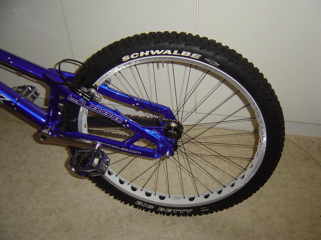

i've been using maxxis minions for my rear wheel for a long time now, there's nothing wrong but i fancy shredding some weight off the bike and after some research the big betty is a lot lighter and grip wise shouldn't be too far back from the minions..
the only problem is they only come in 2.4's, it is an expensive tire and i don't know if it'll fit the tryall rim's width.. has anyone here tried them on a wide rim?
any helps appreciated.

well i got mine a few weeks back and i tried running my usual 16 psi in in the rear with a spesh downhill tube (im very light and im used to low pressure in the minions) , pinched on the first ride!....so in terms of low pressure its no good really, i now run a little more, up to 25psi now!! its been fine, its got plenty of grip, weighs 900g's (400gish lighter than the minions) and its got a larger tire volume than the 2.5 maxxis, being a 2.4 itself. its also a bit wider than the maxxis cos it rubs on my frame a little when my wheel is out of true.
so in my opinion an excellent light grippy tire if you can afford it, and if you're silky smooth or you like slightly higher pressure then i'd rate them over maxxis...
hope i've helped.
steve
