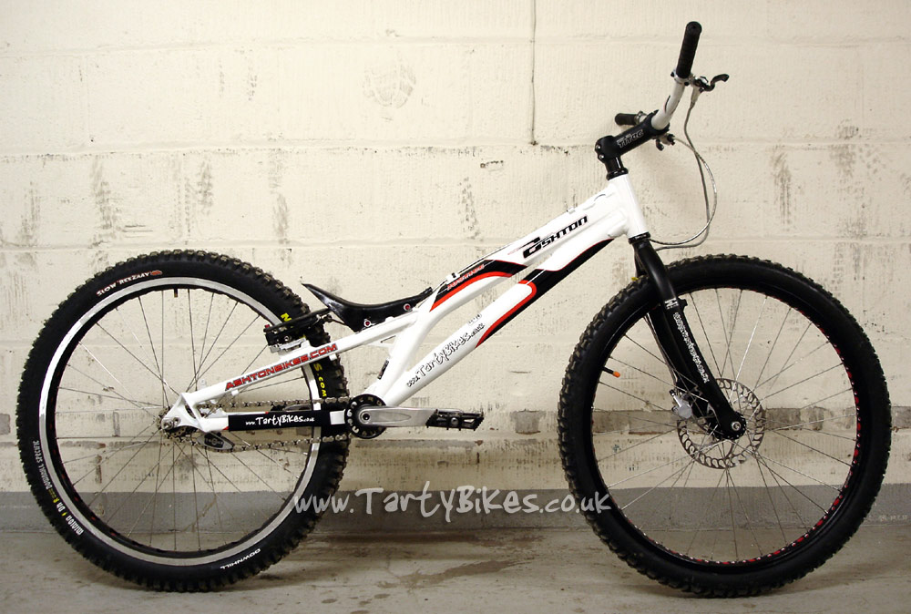

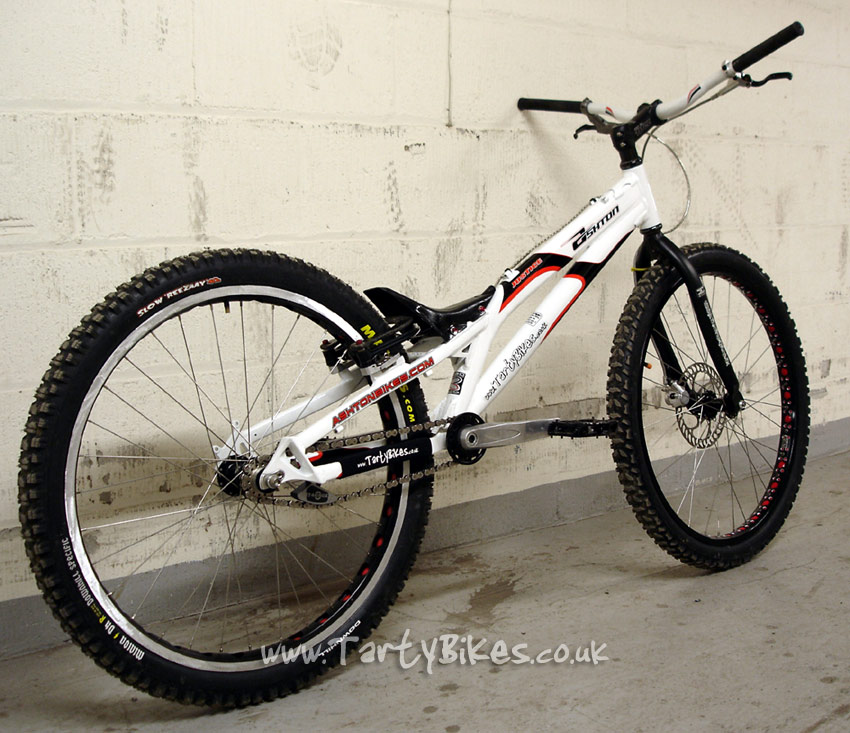

joe b Posted March 15, 2007 Report Share Posted March 15, 2007 That looks hot as foook . The white paintjob looks immense... Cheers,Joe. Quote Link to comment Share on other sites More sharing options...
Watson© Posted March 15, 2007 Report Share Posted March 15, 2007 I've creamed.... Really really like that... looks awesome in White and the Geo sounds spot on! Quote Link to comment Share on other sites More sharing options...
Walleee Posted March 15, 2007 Report Share Posted March 15, 2007 The graphics are just mock-ups, as is the colour.Geometry isn't much different, no, but the BB is around 15mm higher, and obviously the extra wheelbase changes things a lot. Last year's frames were 7005 (you can't weld 7075) and this prototype is U6. There is another 6061-T6 prototype being tested I believe.Disc mount was something Martyn asked us to check over, I think I will be recommending the non-disc versions of the dropouts instead.This is only a prototype frame and is set to be an additional model in the range to the 'standard' Justice (as far as I am aware).the old frame with a 1050 wheelbase and 73 head angle was one of the longer frames out there reach wise! If it had a 1080 wheelbase and 73 head angle you woul need arms like gorrillas to ride it!I wanted this geo (as well as gav bedford) as it will help with comps, the slack head angle is loads better for taps and roll downs and the reach is still short enough for it not to be a pain to get on the rear.the disk mount isnt final, I will advise martyn to either have a beefier one on or non at all.Glad people are liking it though!It's good to know that the R&D is at least seemingly been done 'with' you two, brilliant to hear it wont have a 'silly' disc mount (if at all) but yeh, probobly two of the most imformative post's i've read here. Quote Link to comment Share on other sites More sharing options...

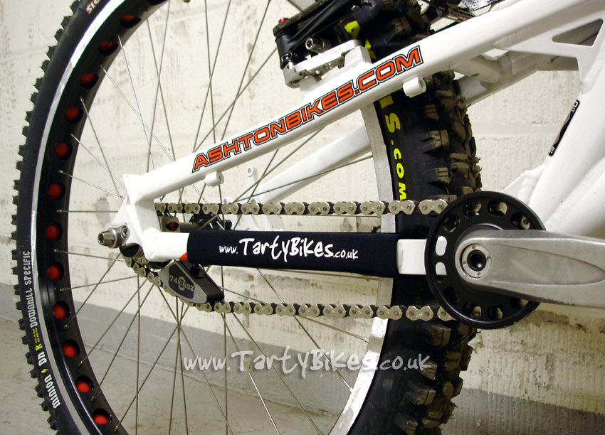

Jamie_Neal Posted March 16, 2007 Report Share Posted March 16, 2007 Very nice. Much prefer the white colour scheme. Aren't the dropouts/disc mount the same as Zebdi/Jack Flash ones? If so, the tabs are about 7mm thick. Quote Link to comment Share on other sites More sharing options...

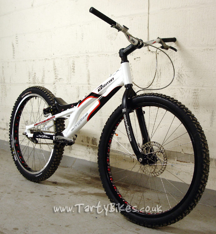

AdamR28 Posted March 16, 2007 Report Share Posted March 16, 2007 New pics:CheersAdam Quote Link to comment Share on other sites More sharing options...
Joe Papasnap Maher Posted March 16, 2007 Report Share Posted March 16, 2007 (edited) Bugger me, loved me other ashton..and this is just next a longer version..aka the sex..this is the next frame for me , yay Edit - ad, did u do them extra holes in the front rim yourself...or is it a new rim?? Edited March 16, 2007 by JoeMaher Quote Link to comment Share on other sites More sharing options...
Waddy Posted March 16, 2007 Report Share Posted March 16, 2007 looks alot nicer in those pics whats the weight of it fully built ? Quote Link to comment Share on other sites More sharing options...
AdamR28 Posted March 16, 2007 Report Share Posted March 16, 2007 11kg with heavy basher rear wheel, non ti pedal axles and non carbon stem, the other lighter rear wheel is significantly lighter! Quote Link to comment Share on other sites More sharing options...
David Biddle™ Posted March 16, 2007 Report Share Posted March 16, 2007 that is one lush bike damm i wish i had an ashton again biddle p.s dose it still have the 73mm shell bb or they brought it back to a 68 shell Quote Link to comment Share on other sites More sharing options...
AdamR28 Posted March 16, 2007 Report Share Posted March 16, 2007 Ali on Adams log in:still a 73mm shell.Joe, I did the front drilling, took aages!! Quote Link to comment Share on other sites More sharing options...
