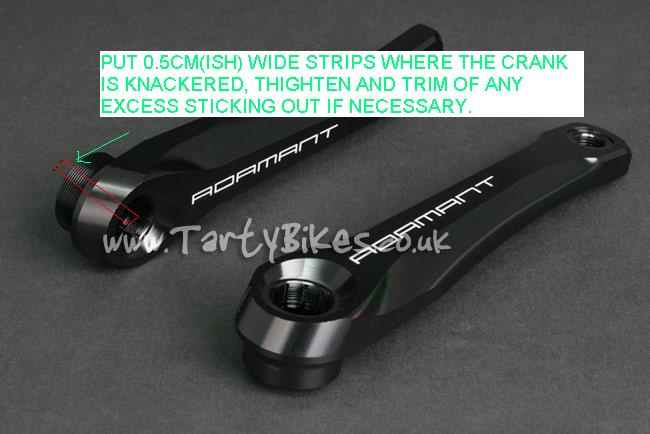

ben_travis Posted March 12, 2007 Report Share Posted March 12, 2007 coke can trick. take a piece of coke can and force it inbetween the bb and crankotehr than that. u could get some weld glue stuff that u make a mix of and put that in. you wont get crank off again though. Quote Link to comment Share on other sites More sharing options...
Brian Bleech Posted March 12, 2007 Report Share Posted March 12, 2007 coke can trick. take a piece of coke can and force it inbetween the bb and crankthis works well did it to mine at the weekend Quote Link to comment Share on other sites More sharing options...

Christophe' Posted March 12, 2007 Report Share Posted March 12, 2007 Haha, Wishful thinking with the coke can trick!Basicaly, once an aluminium isis crank gets damaged slightly by not being mated to the steel bb axle corretcly, it can only get worse.The same goes for putting old isis cranks on a new bottom bracket,,,,even if the the bolts were originaly done up correctly! There is no bodge for this.Unfortunately Isis is fine when it works but has major flaws in its design.New crank arms time! Quote Link to comment Share on other sites More sharing options...
manuel Posted March 12, 2007 Report Share Posted March 12, 2007 if the bb comes with a little washer on the end (like a 1mm washer that sits where the arm tightens up to ... ) take it off - pushes the cranks further onto the splines making the fit tighter. Quote Link to comment Share on other sites More sharing options...
Brian Bleech Posted March 12, 2007 Report Share Posted March 12, 2007 Good luck at getting a coke can to bend effectively with an ISIS spline.......If you try wrapping the coke can round the axle it is impossible to get the cranks on, much easier to do it this way. stopped mine wobbling Quote Link to comment Share on other sites More sharing options...

Guest Posted March 13, 2007 Report Share Posted March 13, 2007 If you try wrapping the coke can round the axle it is impossible to get the cranks on, much easier to do it this way. stopped mine wobblingand the importance of explaining what you mean when advising bodges becomes apparent?'coke can trick. take a piece of coke can and force it inbetween the bb and crank'hardly suggest's taking it apart and carefully cutting strips small enough to fit in the splines......Thanks for explaining to me anyway.... Quote Link to comment Share on other sites More sharing options...
Jsy Ben Posted March 13, 2007 Report Share Posted March 13, 2007 PFT tape wrapped round the bb twice or thrice, should fill the worn gap on the axle. Quote Link to comment Share on other sites More sharing options...
Greetings Posted March 13, 2007 Report Share Posted March 13, 2007 Good luck at getting a coke can to bend effectively with an ISIS spline.......It can be done, you need to slide two thin strips into two opposing sides of the spline. Not easy as with a square taper but it works. Quote Link to comment Share on other sites More sharing options...
