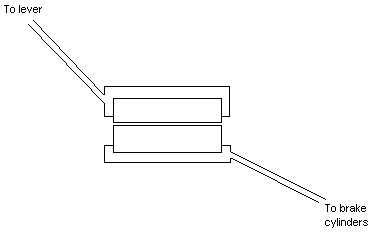

Josephine Posted February 16, 2007 Report Share Posted February 16, 2007 (edited) student loan? you've gotta be kidding... long gone mate... my only worry would it might leek? so if the company thought "ok to stop it leeking we'll make the seals tighter" but then your steering gets stiffer. so the company think "right we'll make it looser" then it starts to leek again then they think "hmm?" i suppose there could be a resevoir or something... be quite interested to see how it works... as for me a long goodridge cable bled with water works fine for me at the mo That's not how it works, really. You can think of it as two separate systems; one above the gyro and one below. So the top system pushes the top half of the gyro down, which just presses the bottom half down (I guess it'd have a roller bearing like a headset does in between the two halves).See cheap diagram, the top half just pushes the bottom, so no fluid moves between the two halves of the brake.Joe x Edited February 16, 2007 by Josephine Quote Link to comment Share on other sites More sharing options...
mafu26 Posted February 16, 2007 Report Share Posted February 16, 2007 That's not how it works, really. You can think of it as two separate systems; one above the gyro and one below. So the top system pushes the top half of the gyro down, which just presses the bottom half down (I guess it'd have a roller bearing like a headset does in between the two halves).See cheap diagram, the top half just pushes the bottom, so no fluid moves between the two halves of the brake.Joe xahh i think i get it now. so there's not a continuous flow of fluid all the way from the lever to the piston? so there must be two pistons inside the heatset that slide over each other. thats pretty sweet i want one nowcheers Quote Link to comment Share on other sites More sharing options...

Shaun H Posted February 16, 2007 Report Share Posted February 16, 2007 (edited) That's not how it works, really. You can think of it as two separate systems; one above the gyro and one below. So the top system pushes the top half of the gyro down, which just presses the bottom half down (I guess it'd have a roller bearing like a headset does in between the two halves).See cheap diagram, the top half just pushes the bottom, so no fluid moves between the two halves of the brake.Joe xWrong there's no way that'd work very well. It's overcomplicated to produce and how the hell would you bleed it?EDIT:From the article:The twosections rotate over each other and the Hydraulic brake fluid can pass unhindered through the hoses and rotor to provide full braking power whilst the bars are spinning unhindered – and at no risk of damaging the rear hose. Edited February 16, 2007 by Shaun H Quote Link to comment Share on other sites More sharing options...

RobinJI Posted February 16, 2007 Report Share Posted February 16, 2007 Wrong there's no way that'd work very well. It's overcomplicated to produce and how the hell would you bleed it?EDIT:From the article:Yeah, I was just gunna say, how the hell would that work with an open system break? I suppose with a closed system it would work if you bled both halves individually. Quote Link to comment Share on other sites More sharing options...
Shaun H Posted February 17, 2007 Report Share Posted February 17, 2007 Yeah, I was just gunna say, how the hell would that work with an open system break? I suppose with a closed system it would work if you bled both halves individually.If you could bleed them it'd work. But the tolerances would have to be spot on for it to work without leaking anything and being really stiff. I imagine it'd be harder to make compared to whatever they've actually done too. A cross section of the design would be cool to see. Quote Link to comment Share on other sites More sharing options...
