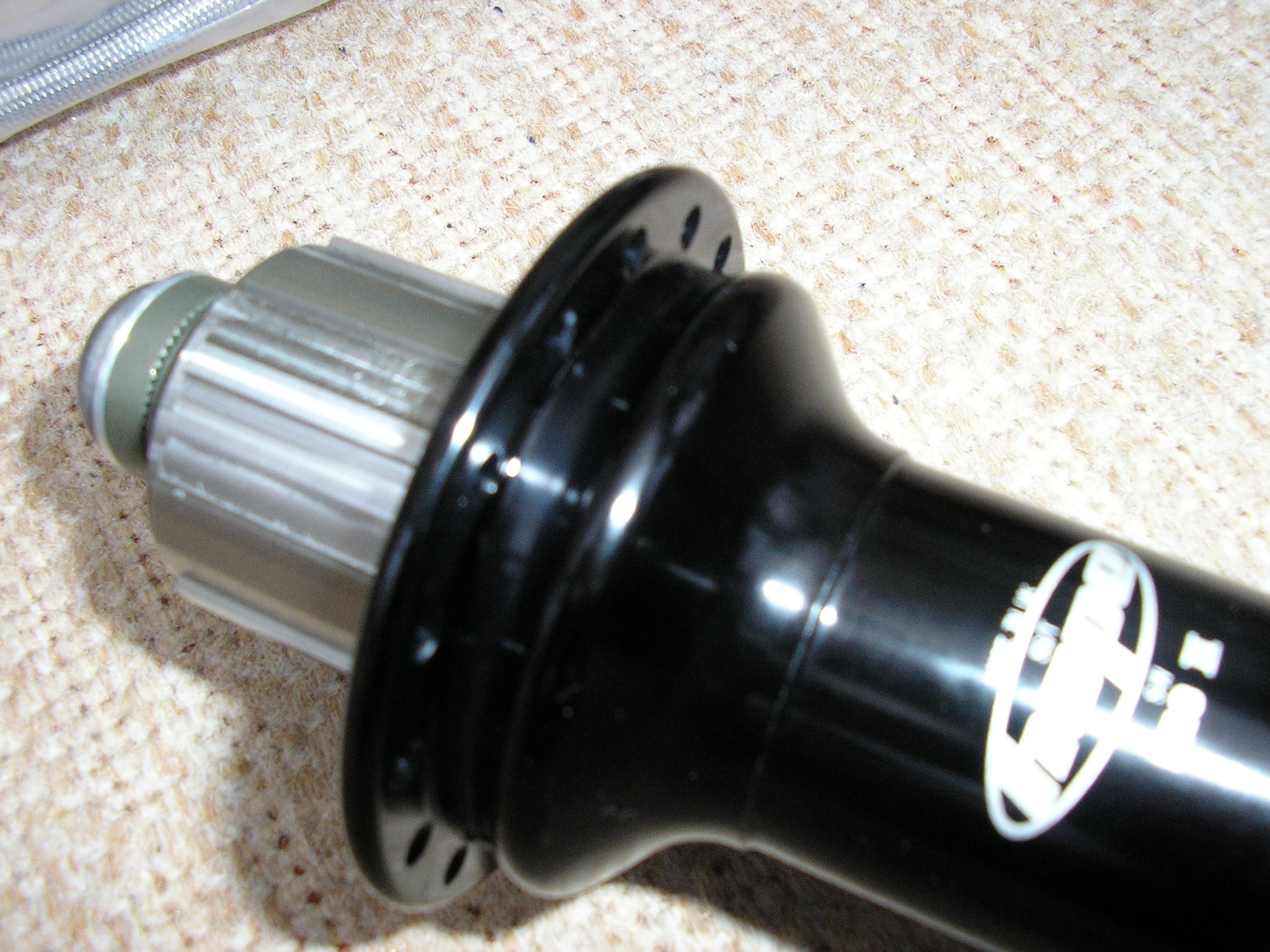

im unsure on how to post pictures, but i have some pictures of the new type shell, it has more of a bulge on the area they were breaking, any that do manage to break on the older shells i would imagine will be replaced with the new type shells
that number of broken hubs is not really a lot either to consider that they have made a few thousand of these hubs and only around 8 to 10 actaully cracking (reported back to hope that is) there may be more.

Theres the picture that you sent me ash.
theres nothing wrong with the internals in the current hubs, the splittage of the shells is most likley due to spoke stress. The broken hubs I have seen have still had perfectly functioning internals.
