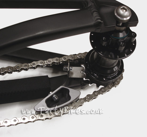

ogre Posted January 20, 2007 Report Share Posted January 20, 2007 (edited) levers are the same(length etc), just the machining matches the style of the frames+everything else.steals thread, for if+when tarty boys read it. would the 74 kingz tentioner fit a mod? (not bothered if it needs modifying a little ) Edited January 20, 2007 by ogre Quote Link to comment Share on other sites More sharing options...

Has anyone seen my shoe? Posted January 20, 2007 Report Share Posted January 20, 2007 would the 74 kingz tentioner fit a mod? (not bothered if it needs modifying a little )Why not, its got a 10mm hole for the wheel bolt to go through so aslong as your not running king fun bolts you should be fine, if you are, drill it. Quote Link to comment Share on other sites More sharing options...
RobinJI Posted January 20, 2007 Report Share Posted January 20, 2007 (edited) Think the titanium-steel thing also has something to do with snapping chains. Apparently the properties of the titanium add to the already large problem of the 16t ring snapping chains. Can't remember how though.The lever blades are Deng, so like most Deng parts, they'll be identical other than aesthetics and about 0.5g. Spose if you did stress analysis on them then one would technically be stronger than the others. But meh, who gives a toss, its a lever blade.Edit:The 74kings tensioner might not fit a mod. Have a look at this picture:With the smaller sprocket on a mod, the fitting plate would be really low down, and the runner would have to be really high up, which would put the spring plate at a really harsh angle, either bending the spring plate or over tensioning it.The only way I can see around this is to move the axle whole alot thurther down the mounting plate to get it at a better angle, but its a bit of a long shot. Weight and see what tarty have to say about it first anyway. Edited January 20, 2007 by Dont you Just Hate it When... Quote Link to comment Share on other sites More sharing options...

joewhite Posted January 21, 2007 Report Share Posted January 21, 2007 ash lad, its because some people's chains just dont want to go tight no matter how much you move you back wheel, take links out etc. I have the same problem, sort of. But its just an idea people are thinkin of. Quote Link to comment Share on other sites More sharing options...
munkee Posted January 21, 2007 Report Share Posted January 21, 2007 cool, thanks for all that dave. why would you lot want one on your mods anyways? its just something to hit???some gear ratios make it so that if you have the chain with one extra link wheel is pulled right back in dropouts and so brakes dont line up. Then if you take a link out the wheel has to go in so far its pressed to the mounts and you cant do the chain up. To solve it you have to buy either one half link or a whole half link chain which people seem warey of (ive ran mine fine for ages now). So a tensioner is the only way to go. Its due to silly gear ratios and certain companies not being able to weld in the right places. Quote Link to comment Share on other sites More sharing options...
ogre Posted January 21, 2007 Report Share Posted January 21, 2007 cool, thanks for all that dave. why would you lot want one on your mods anyways? its just something to hit???'cause to get the right tention (for me anyway) i have my wheel to far back for my maguras to hit the rim square, uneven pad wear anyone? and i wana just push my wheel as far in as possible without fannying around pulling it back mid ride etc.what would i need to do to make it work for a mod? Quote Link to comment Share on other sites More sharing options...
