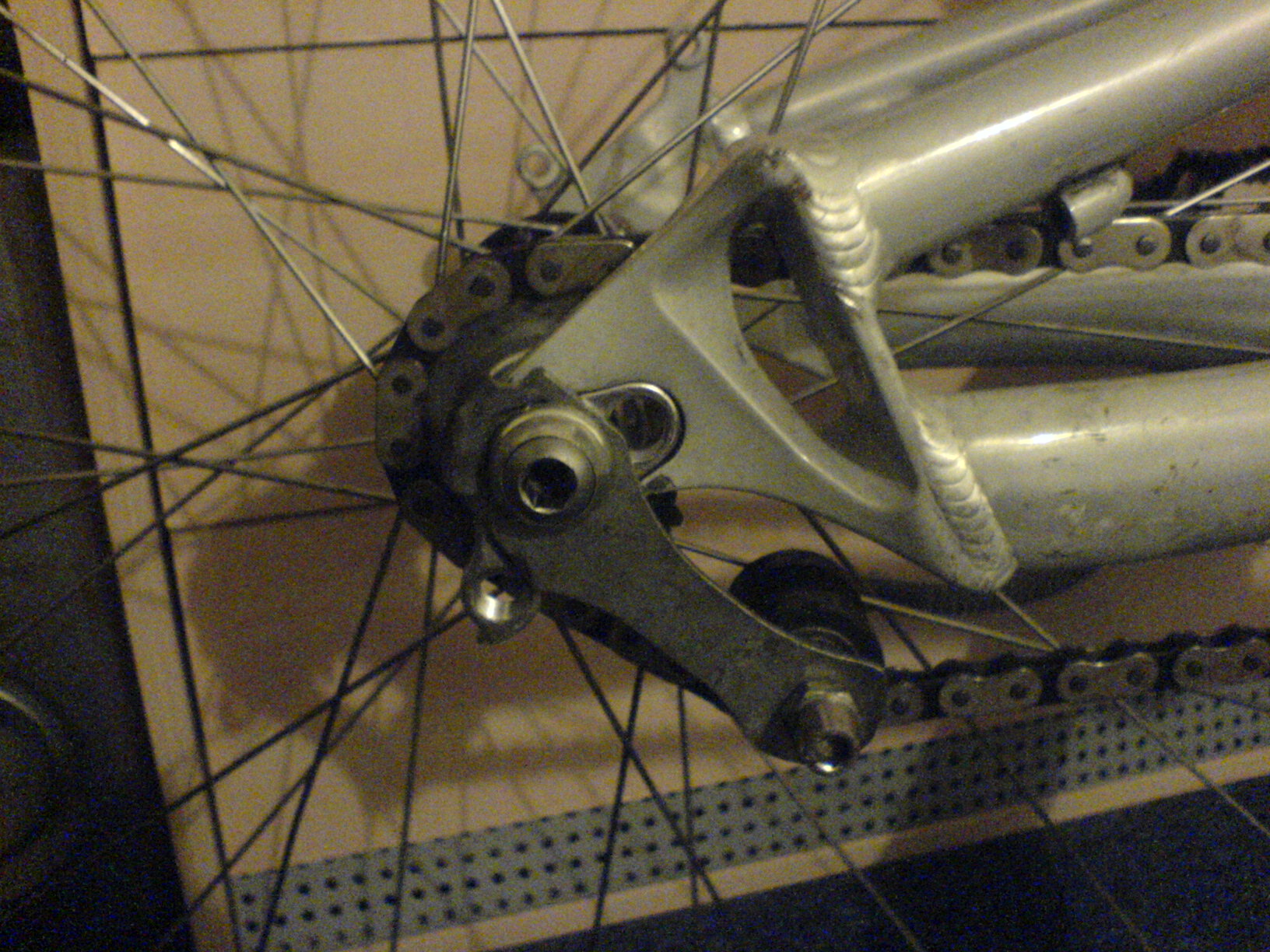

Bigman Posted January 18, 2007 Report Share Posted January 18, 2007 Is that the type of thing you mean Beau, it is held on using a "L" shaped bracket which is clamped between the axle and frame, It works so well i am geting rid of my Rolhoff!Adam Quote Link to comment Share on other sites More sharing options...
B.E.A.U Posted January 18, 2007 Author Report Share Posted January 18, 2007 i never seen that befor but where your hanger is off thats what mine looks lik now. if you get me Quote Link to comment Share on other sites More sharing options...
Ben@LeicesterTrials Posted January 18, 2007 Report Share Posted January 18, 2007 Get a mech, were the main big alen key bolt is what screws into the mech hanger take the bolt out, were the bolt slots in to on the mech to screw in the mech hanger grind it down about half way and file it so it's nice and straight then put the King fun bolt though it and clamp it up onto your frame. Quote Link to comment Share on other sites More sharing options...

Bionic Balls Posted January 19, 2007 Report Share Posted January 19, 2007 half a mech...it's sprung too...so no tight spots..hard to land on cos it's inside the stays...lovely.adam Quote Link to comment Share on other sites More sharing options...
Heatsink Posted January 19, 2007 Report Share Posted January 19, 2007 Some ideas that can be adpted. The roller can be bought from CRC, 6mm Alu sheet arm (or thicker). CAD print out stuck onto the sheet to allow cutting out to shape with a hand saw.Maybe make a sort of mech hanger from sheet alu to provide the additional mounting hole for holding the arm securely.Steve Quote Link to comment Share on other sites More sharing options...
