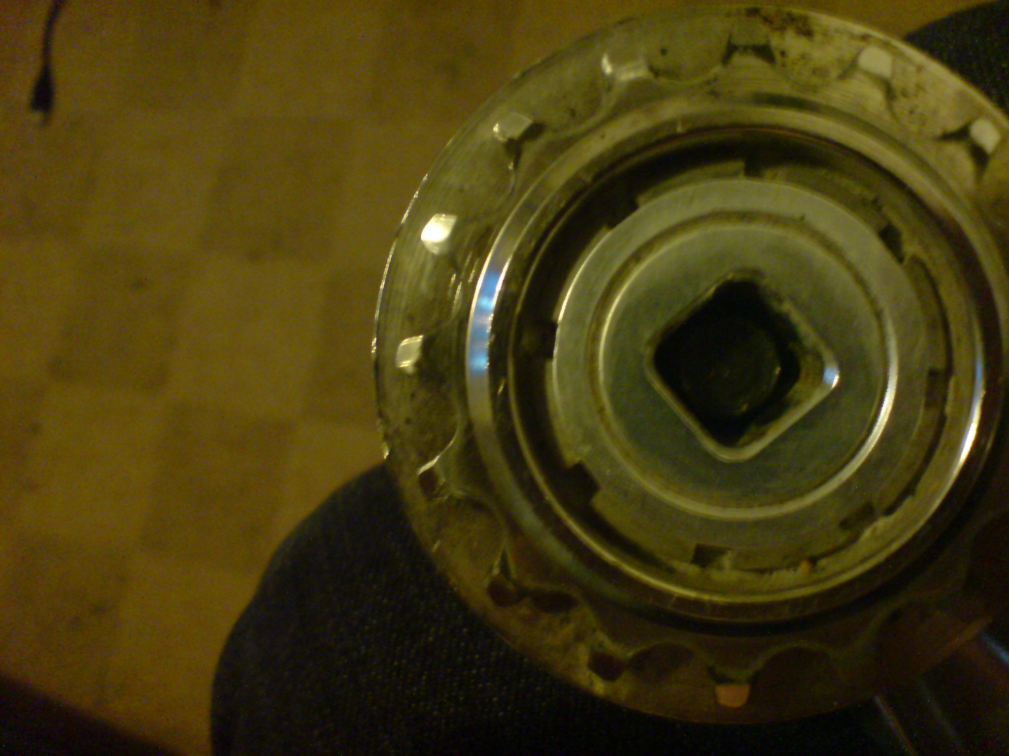

AdamR28 Posted January 7, 2007 Report Share Posted January 7, 2007 Any chance of a detailed pic of the teeth on the bashring/sprocket? Often, new chain + old sprocket = problems...If the teeth have worn slightly to fit the existing chain, as soon as you fit a new chain it wont mesh properly. I'd suggest giving Middleburn a call if that is the case, speak to Matt, and see if you can send the bashring back to have the teeth re-cut.CheersAdam Quote Link to comment Share on other sites More sharing options...

Alexxx Posted January 7, 2007 Author Report Share Posted January 7, 2007 Here's a pic of the teeth hope it helps, they don't look too mis shapenCheers for the help so far guysAlexxx Quote Link to comment Share on other sites More sharing options...
AdamR28 Posted January 7, 2007 Report Share Posted January 7, 2007 Hmm, don't look amazing...Try rotating the bashring 180 degrees and try again. This will mean your power stroke will be with a fresh set of teeth.Check the join very carefully too, with the Kool chains the pin needs to go in dead straight because of the mushroomed heads. If its a dodgy join the link will bulge slightly, or a small amount of swarf will appear. Quote Link to comment Share on other sites More sharing options...
