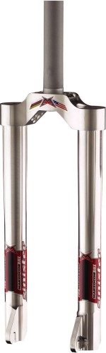

Brian Bleech Posted January 8, 2007 Report Share Posted January 8, 2007 marzochi (sp???) make 24" rigid forks, to a similar design you want, but no disk mount and super expensive. Nice though Quote Link to comment Share on other sites More sharing options...
