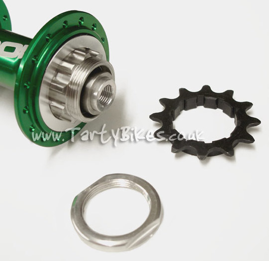

Guest Posted December 26, 2006 Report Share Posted December 26, 2006 Yes, but from looking at this picIt look's like there is only about 4-5mm of space on the axel before it enter's the lockring(?) nut. So I doubt a full bolt would even fit...What material is the existing axel? If it's aluminium you could try having a steel one made to the same specifications, it would certainley be stronger just from the material change...... Quote Link to comment Share on other sites More sharing options...
