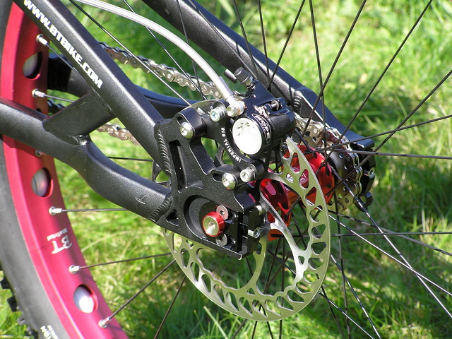

Greetings Posted November 23, 2006 Report Share Posted November 23, 2006 I'm thinking about going to dual disc next year. I had a 20" DD and the rear wheel did flex quite a bit so I'm worried how bad this mightl be on a 26". How often do you have to get a new wheelbuild and what spokes do you use? Quote Link to comment Share on other sites More sharing options...
paolo Posted November 23, 2006 Report Share Posted November 23, 2006 (edited) Wheelsmith 14g spokes. Had mine for a while, never had it dished, get them built properly and they should last a while... Edited November 23, 2006 by paolo Quote Link to comment Share on other sites More sharing options...
tipsy Jock Posted November 23, 2006 Report Share Posted November 23, 2006 I had a rear avid for a while, that used to flex around all over the place, i think pad wobble contributed a lot to that as well though. Quote Link to comment Share on other sites More sharing options...
rav Posted November 23, 2006 Report Share Posted November 23, 2006 I have 3 cross both side butted spokes 2.0/1.6/2.0 and all is OK.Its only some "stop delay" effect compared to rim brakes but nothing flex to the side or something. Quote Link to comment Share on other sites More sharing options...
durkie Posted November 24, 2006 Report Share Posted November 24, 2006 i can tell a difference, but you get used to it. i'm running 14g/3x both sides , but i don't see any reason at all why you would have to rebuild your wheel because of it. cranking down on the pedals causes a shit ton of flex, but you don't notice it as much because you're not stationary, like when on the rear. Quote Link to comment Share on other sites More sharing options...
