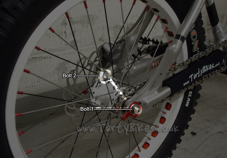

omgnoseat Posted February 21, 2007 Author Report Share Posted February 21, 2007 ok lil update now;I've locktite't my wheel and it's working great now, except for 2 things:- When i try to tighten my wheel at the rear end bolts (bolt 1), the bolt next to the tire (bolt 2) spins aswell, so my wheel won't tighten up at all and the axle just keeps spinningjust to clear up what i mean:- when i give a reasonbly hard swing to my wheell it won't turn further that like 3/4 circle, will this have any affect when i ride, like power in pedal kicks or something or doesn't it really matters?Thanks for the help so far btw, it has helped me out alot Quote Link to comment Share on other sites More sharing options...
