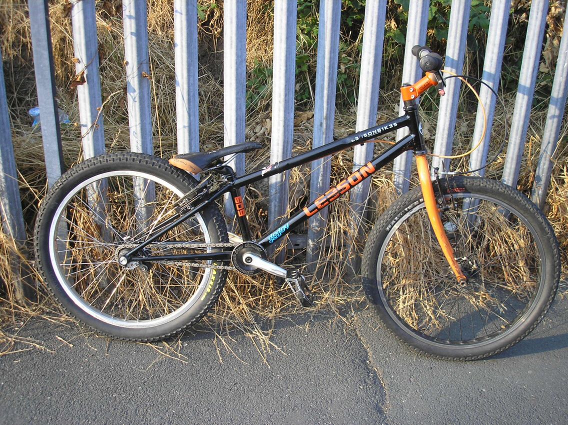

Brian Bleech Posted September 12, 2006 Report Share Posted September 12, 2006 74 (I was gonna go for 74.5 at one point ) is fairly standard in bmx, it makes the bike feel aggressive and responsive when on two wheels. The steeper headangle also gives me a touch more reach while keeping the bike short and flicky. A slacker headangle is better for hooks and taps, but I don’t really do them, I can hook it on near vert walls, but haven’t got the knack of vert ones yet and I just bunnyhop up stuff I just like a bike that feels nice on just blasting about on two wheels (I find bikes with a slack headangle feel sluggish), while feeling good on the back wheel (but not like a pogo stick) and I have on so I am happy[attachmentid=7004] Quote Link to comment Share on other sites More sharing options...

Brian Bleech Posted September 13, 2006 Report Share Posted September 13, 2006 are they mini pegs on there????? if so are they any good yeah they are superstar micro pegs on the front. They are pretty good if you like doing dropout tricks, there is enough to grin on if you wish and you can just about get your feet on for things like hang fives.Remember you have to run a 10mm bmx hub, i have a demolition bulima hub which is pretty good and only about £30. Quote Link to comment Share on other sites More sharing options...
