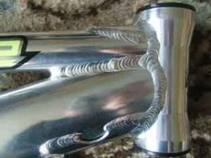

poopipe Posted September 1, 2006 Report Share Posted September 1, 2006 righty.I have a t-pro frame and a t-lite frameThe t-pro frame has a headset and a bottom bracket in it and I want to put both of these items in my t-lite.my spanner won't fit my BB tool so I figured I'd start with the headset...I pulled the bearings and the top internal cup (not the black bit, the bit inside it that the bearings sit in) out of the t-pro headtube and compared it to the size of the hole in the headtube of my t-lite and it looks a bit like the cup is too big to fit inside the black cup holding thingy.I'm a bit frightened of just bashing it in in case I bust something - should the internal cup thing fit inside the black thingy or not? I don't really want to buy a new headset for it, I want to spend my money on beer instead Quote Link to comment Share on other sites More sharing options...

poopipe Posted September 1, 2006 Author Report Share Posted September 1, 2006 (edited) yer thats what im thinking on the t-pro (source frame) there's the tube, inside that is a black thingy and inside that is another cup thing and inside that are the bearingson the t-lite (destination frame) there's the tube, inside that is a black thingy. ergo, (what with them both having internal headsets) the 'another cup thing' must go into the black thing on the t-lite or there'd be a bit missingI'm not sure the black things are supposed to come out Edited September 1, 2006 by poopipe Quote Link to comment Share on other sites More sharing options...

poopipe Posted September 1, 2006 Author Report Share Posted September 1, 2006 (edited) there's nothing missing from the t-lite at all - JT is gooodim not home so i've only got the lovely pics JT sent me - the black things at either end of the headtube are what im talking about, I have these on both frames and on the t-pro there are other cups inside them[attachmentid=6806] Edited September 1, 2006 by poopipe Quote Link to comment Share on other sites More sharing options...
Caleb Posted September 1, 2006 Report Share Posted September 1, 2006 yeah there cups, i wasnt sure if j-t had included the headset or not thats all.you should bea able to transfer your bearings etc straight over then ? Quote Link to comment Share on other sites More sharing options...
poopipe Posted September 1, 2006 Author Report Share Posted September 1, 2006 so, in this pic.... the red things are the same as my black things and that yellow thing is what I though was an extra cup ??does this mean I've pulled the bearing holder apart and confused myself? its got caged bearings inside it. Quote Link to comment Share on other sites More sharing options...
Caleb Posted September 1, 2006 Report Share Posted September 1, 2006 yup that yellow thing is a sealed set of headset bearings, try putting it back together and it should slot into the cup just nicely, dont forget all spacers and locking rings etc when building the headset back up Quote Link to comment Share on other sites More sharing options...
poopipe Posted September 1, 2006 Author Report Share Posted September 1, 2006 yup that yellow thing is a sealed set of headset bearings, try putting it back together and it should slot into the cup just nicely, dont forget all spacers and locking rings etc when building the headset back upthere's my problem - it won't slot in easilyi'll get the hammer out, that'll learn it nice to know you get a sealed headset as standard on a t-poo then Quote Link to comment Share on other sites More sharing options...

poopipe Posted September 1, 2006 Author Report Share Posted September 1, 2006 i think i've cracked it (the problem, not the frame) it seems not all internal headsets are created equal so i've popped the cups out of the t-pro and put em into the t-lite. The bearings fit now but i'm not entirely convinced i've bashed the cups in far enough. I managed to lose a spacer for my booster somewhere along the line which is a bit of a tosser but since im crippled for at least another week there's no rush to get it built. Quote Link to comment Share on other sites More sharing options...
JT! Posted September 1, 2006 Report Share Posted September 1, 2006 (edited) Yeah the t-lite does have cane creek zero stack cups in the frame.The bearings should just sit in really easily, there should be no bashring what so ever. Mat = FatJT= Medium WeightMat + Ashton Justice + a few months = f**ked Frame.JT + T-lite + 2 years = Ergo. Weight to time ratio = T-lite > JusticeMat + Another Justice = Mat likes JusticesMat likes Justices = Mat likes t-lites even more. Edited September 1, 2006 by JT! Quote Link to comment Share on other sites More sharing options...
