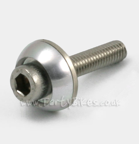

Mark W Posted August 16, 2006 Report Share Posted August 16, 2006 Are you after the ones that take a 15mm spanner or a 5mm allen key?e.g. that or a "proper" nut? Quote Link to comment Share on other sites More sharing options...
twisted Posted August 16, 2006 Author Report Share Posted August 16, 2006 there proper nuts, that pic is a bolt and i pretty sure there 15mm. Quote Link to comment Share on other sites More sharing options...

Dan6061 Posted August 16, 2006 Report Share Posted August 16, 2006 Mark that aint precisly right because my back 10 mm hub uses a 17mm spanner to undo and do up. I think Mark means that if it's say, a T-Pro wheel, it'll have 10mm axels, so it'll be those nuts he'll be after. Which usually take a 15mm spanner to tighten/loosen.If he has a T-mag wheel (Sealed bearings) then he'll need the ones that take a 5mm allen key (in the picture Mark posted).If it's like on the old T-Birds (not sure if the new ones are like that) where they have a 14mm axel, then hell need wheelnuts for a 14mm axel. - Usually a 19mm spanner.I'm in such an advise-giving mood today..what work does to me.. Quote Link to comment Share on other sites More sharing options...
