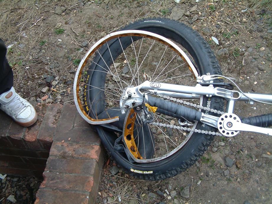

Onza Kieron Posted July 31, 2006 Report Share Posted July 31, 2006 What I meant was, how has he missed the epidemic about Echo rims being absoloubt Turd, don't make me post a piccy of my mates. OKOK I will. Quote Link to comment Share on other sites More sharing options...
Danny Kearns Posted July 31, 2006 Report Share Posted July 31, 2006 What I meant was, how has he missed the epidemic about Echo rims being absoloubt Turd, don't make me post a piccy of my mates. OKOK I will.Thats Brett Penfold's rim, very nice, seen it all before, but remember this guy has been on this forum all of an hour, so he is not going to no the news is he. Also have you seen how big the line was what Brett did his rim on. Dan. Quote Link to comment Share on other sites More sharing options...
philking Posted August 1, 2006 Report Share Posted August 1, 2006 (edited) I have explained this before but there is no harm in doing it again:The 06 Echo rims are bad because of their shape - They have a very square cross section which meant that whenever they are hit the force isn't channeled down into the spokes and dispersed over a large area, but it is contained in the sidewalls that then fold because of the high pressure. Basically, they were a nice idea, but they weren't as good as hoped/expected.The Ronnie rim is pretty good for the rear, i had one which lasted for around 8 months with maybe 10 grinds in total.Personally however i would have to say Tryall seem to be your best bet. I know people slag them off and discribe them as cheese etc, but they are still the most popular rims around, and thats because despite them having a few weaknesses, no company has brought out a rim that is better (although i would say Onza has provided equal alternatives).Of course there are other rims out there which aren't trials specific but are still good - Alex Dx32 and Mavic Ex721 (used to be called the D521). The main problem with the mavic is they are rather narrow and therefore can't be used with rim brakes in most modern frames. I would suggest reading the info on TartyBikes because it is very accurate and informative. Edited August 1, 2006 by philking Quote Link to comment Share on other sites More sharing options...
