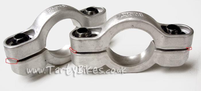

Robwalker Posted July 18, 2006 Report Share Posted July 18, 2006 I had this problem,[attachmentid=6069] I found that if you file down the little lumps you can get a better clamp on the calipers, but of corse not too much as you dont want to put too much stress on the caliper. Quote Link to comment Share on other sites More sharing options...
