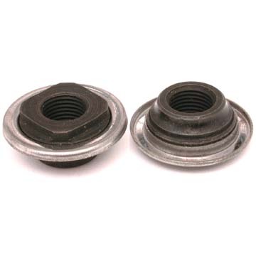

ollie2000 Posted July 9, 2006 Report Share Posted July 9, 2006 Not trying to sound like a tard but what is a cone please don't abuse me for this question Quote Link to comment Share on other sites More sharing options...
aener Posted July 10, 2006 Author Report Share Posted July 10, 2006 They're the bit's on the axle that screw into the hub to keep the bearings in. (To be blunt)If you've got a sealed hub, you wont have any...Flipp Quote Link to comment Share on other sites More sharing options...
Lawnmowerman Posted July 10, 2006 Report Share Posted July 10, 2006 [attachmentid=5912] Quote Link to comment Share on other sites More sharing options...
