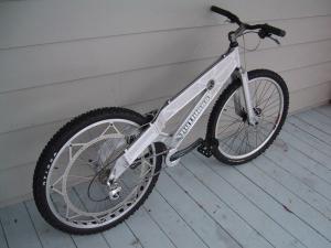

the judge Posted July 3, 2006 Report Share Posted July 3, 2006 (edited) id like to see the bike with the rotor the size as the wheel It's kinda been thought of with the Ruthless trials bike, have a look at the rear brake: Edited July 3, 2006 by the judge Quote Link to comment Share on other sites More sharing options...
