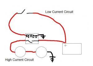

Danny Posted July 4, 2006 Report Share Posted July 4, 2006 If you wired them up like that the switch would just end up melting. Most switches unless there some big heavy duty things cant take the current that the spots will be drawing. The relay acts as a kind of remote switch separating the low and high current circuits. Quote Link to comment Share on other sites More sharing options...

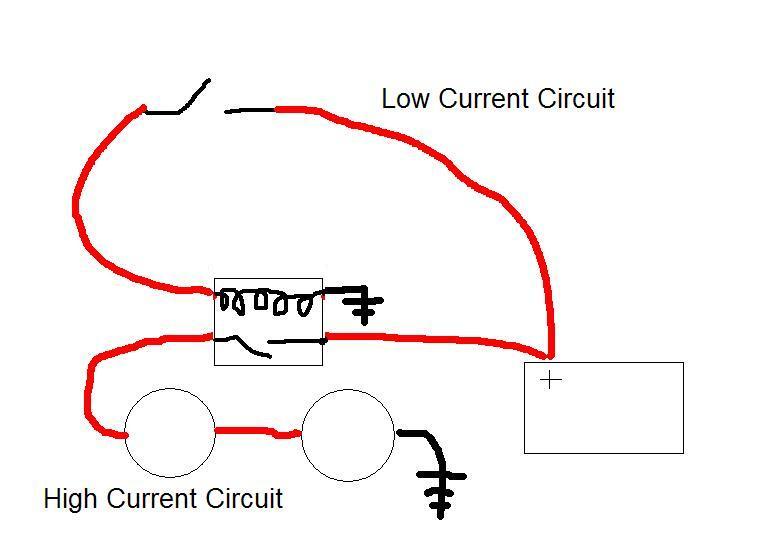

nmt_oli Posted July 4, 2006 Report Share Posted July 4, 2006 (edited) You will need the relay, and some beefy wiring. dont forget spare builbs and fuses. Heres a diagram, hope it makes sense.sorry its so small, any Qs just ask. Edited July 4, 2006 by nmt_oli Quote Link to comment Share on other sites More sharing options...

nmt_oli Posted July 4, 2006 Report Share Posted July 4, 2006 Gavyn L said: slightly off topic but is a car wired in series or parallel. and should your earth not go back to either the chassis or the neutralDepends which bit your lookign at wheather its series or parralel, but nominally paralel. And the earth does go back to the battery negative, the bodywork of the car is connected to it. Gavyn L said: also is a relay a small magnetic switch which converts a small voltage into a larger voltage cuircuit?most relays have 4 terminals, 2 inputs, 2 outputs. one set is for the low current 'signal', the other set for the high current 'application'.the signal current triggers a switch inside the relay, switching on the application current. Is very useful, as you dont have a high current going through a switch directly, and means a shorter route for high current wires. adamtrials said: Why would anyone in Mongol want to buy these modified and clapped out cars that have just driven thousands of miles? Thats the bit i dont get about this whole rally thing...They dont get a lot of our cars over there, so it is novelty/better than what on offer. Quote Link to comment Share on other sites More sharing options...

Danny Posted July 4, 2006 Report Share Posted July 4, 2006 Something like this 'should' work [attachmentid=5806]When you complete the low current circuit (i.e. press the switch) the coil in the relay turns into an electromagnet and latches the switch inside the relay. Quote Link to comment Share on other sites More sharing options...
tomturd Posted July 5, 2006 Author Report Share Posted July 5, 2006 nmt_oli said: You will need the relay, and some beefy wiring. dont forget spare builbs and fuses. Heres a diagram, hope it makes sense.sorry its so small, any Qs just ask.That looks good. I can understand that In 'real size' does it have the numbers for the relay? I can see somethings written around it but cat quite make them out. Can anyone else confirm it'll work? adamtrials said: Why would anyone in Mongol want to buy these modified and clapped out cars that have just driven thousands of miles? Thats the bit i dont get about this whole rally thing...My cars only on 77,000 miles, will be on about 86,000 id guess by the time we get there. So not exactly as if it'll be totally buggered. Plus people over there are generally poor and cant afford cars. Auctioning off 150 relativly new to them cars will let people who otherwise wouldnt be able to afford cars to buy them. I'll take a couple of pictures of the kind of cars out there and you'll see that the cars they have already are pretty shit.Plus its part of the contract we signed that the car has to be in good order when we hand it over, IE no ripping the back seats out. JTM said: I can also confirm that mk3 SI seats are comfy and have uprated side bolstersHmmm uprated side bolsters? Ours kinda have sticky out bits on the sides... not sure if they came out of an SI though.EDIT: nah, just found some on ebay, ours most definatly are not the Si ones. Danny said: Something like this 'should' work [attachmentid=5806]When you complete the low current circuit (i.e. press the switch) the coil in the relay turns into an electromagnet and latches the switch inside the relay.I have no idea what that diagram is meant to mean Quote Link to comment Share on other sites More sharing options...
adamtrials Posted July 5, 2006 Report Share Posted July 5, 2006 Danny said: Something like this 'should' work When you complete the low current circuit (i.e. press the switch) the coil in the relay turns into an electromagnet and latches the switch inside the relay.Theres no resistor on the switching circuit, so the current will be the same on both sides But yeah, i think that should work with a few corrections... Quote Link to comment Share on other sites More sharing options...
