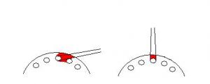

Mark W Posted June 12, 2006 Report Share Posted June 12, 2006 If you imagine the one on the left is a spoke in a 3X lacing pattern (due to the way you twist the hub, meaning the spoke goes out at an angle), then imagine the right is radially laced, there's more material between the edge of the spoke hole and the edge of the hub in the direction the spokes being pulled in, so you have more strength basically There's less material stopping you from ripping the spoke out of the flange if you run radial. Quote Link to comment Share on other sites More sharing options...

PaRtZ Posted June 12, 2006 Report Share Posted June 12, 2006 If you imagine the one on the left is a spoke in a 3X lacing pattern (due to the way you twist the hub, meaning the spoke goes out at an angle), then imagine the right is radially laced, there's more material between the edge of the spoke hole and the edge of the hub in the direction the spokes being pulled in, so you have more strength basically There's less material stopping you from ripping the spoke out of the flange if you run radial.Nice diagram, well explained Quote Link to comment Share on other sites More sharing options...

2sixstreet Posted June 12, 2006 Report Share Posted June 12, 2006 Nice diagram, well explained Well explained but I dont totally agree. Yes theres less material but radially laced spokes are in compression whereas 3X are primarily in tension (due to being tangential). So, where the spoke joins the hub it is trying to push the material from under the head of the spoke towards the centre of the hub, not trying to rip the flange apart.Radial lacing is bad for disc brakes because when you are braking, the rim of the wheel is still trying to roll whilst you stop the hub which tends to 'roll up' the spokes and stress them out. You can get away with this using rim brakes because you are stopping at the rim and the inertia at the hub is quite small comparitively. Quote Link to comment Share on other sites More sharing options...
Mark W Posted June 12, 2006 Report Share Posted June 12, 2006 Well explained but I dont totally agree. Yes theres less material but radially laced spokes are in compression whereas 3X are primarily in tension (due to being tangential). So, where the spoke joins the hub it is trying to push the material from under the head of the spoke towards the centre of the hub, not trying to rip the flange apart.Radial lacing is bad for disc brakes because when you are braking, the rim of the wheel is still trying to roll whilst you stop the hub which tends to 'roll up' the spokes and stress them out. You can get away with this using rim brakes because you are stopping at the rim and the inertia at the hub is quite small comparitively. The top of the wheel will still be trying to rip the spokes out though, in that it's still effectively working by "hanging" the hub from the spokes as you roll along? Quote Link to comment Share on other sites More sharing options...
