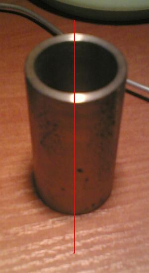

Greetings Posted May 27, 2006 Report Share Posted May 27, 2006 Go to a turner and have him make you a 31.8 to 25.4mm conversion, then just cut it in half so it can be mounted on the bars and bob's your uncle Got one of those at home, never used it though. Quote Link to comment Share on other sites More sharing options...

Greetings Posted May 27, 2006 Report Share Posted May 27, 2006 Just in case this is of any help:[attachmentid=4949] [attachmentid=4951]Obviously the sleeve needs to be cut in half along the red line or you won't be able to get the bars in. Inner diameter is 25.4, outer 31.8 Quote Link to comment Share on other sites More sharing options...

Greetings Posted May 28, 2006 Report Share Posted May 28, 2006 Nope, it doesn't have to stick out. This was just done so that I could cut it to whatever width I wanted, without risking it being too narrow. Quote Link to comment Share on other sites More sharing options...
