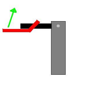

Mark W Posted April 8, 2006 Report Share Posted April 8, 2006 Nah, you slip the ring-spanner over the end of the blade, then push it round, basically... Paint time Similar to this, red bit being the ring-spanner slotted over it, obviously. Just use your head and you'll see the best place to put it Quote Link to comment Share on other sites More sharing options...
David Posted April 8, 2006 Author Report Share Posted April 8, 2006 Ah I see, so your basically just forcing the brake lever down your bars?Dave Quote Link to comment Share on other sites More sharing options...

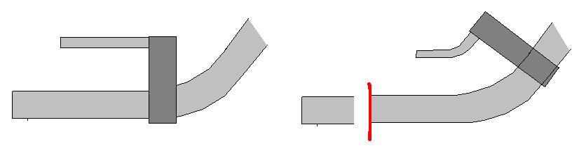

Mark W Posted April 8, 2006 Report Share Posted April 8, 2006 You're basically making it go \_ instead of just __, so you move the lever body down the bars, then bend the blade out to the right point, if you get me? Just go easy, and do it bit by bit. Oh, and if you think "Just a bit more...", don't do it, 'cos you will do it too hard and snap the blade, it's just the way it is Thinking about it, I've got a pic I made for someone about it ages ago... Quote Link to comment Share on other sites More sharing options...
