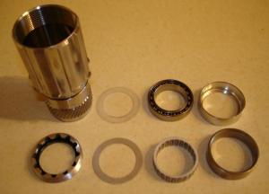

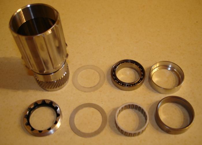

ye the axel will just push out and then you need to take the lock nut out of the freehub body. you dont really need to use the chris king tool i just used a pair of long nose pliers and opened them up and twisted it out that way. then just take the washers and bearing out and put them in your new one. it's all pretty striaght forward even i can do it.
