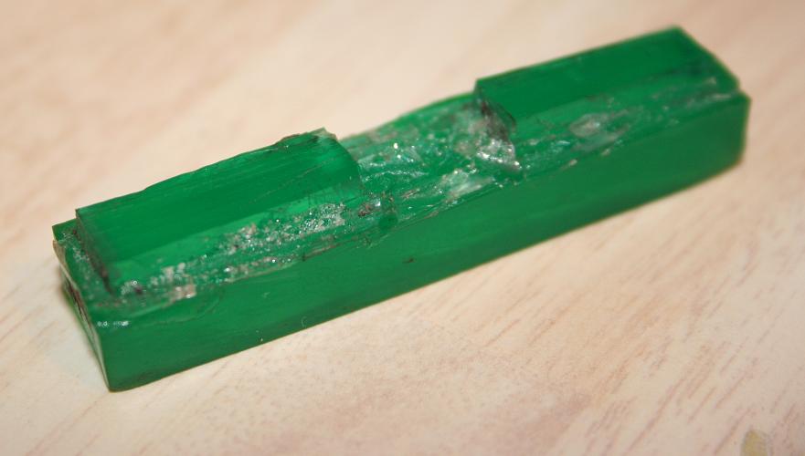

Mark W Posted March 25, 2006 Report Share Posted March 25, 2006 Sweet, this is what i've been looking for, im assuming there a good bit in there for a few pads mark?Is this felix from poland your talking about? One 50mmx10mmx10mm block will do one Powerpad backing, so you get enough for a pair of pads.Either way, cheaper than doing it any other way?I made up mine, and didn't really like them. They seem to be more hype than anything, and the "My pads are wearing quickly" stories that are floating around haven't really done much to change my mind. Ah well, I'll just keep on using the pads I know which are awesome, although no-one else seems to accept it 'cos they're not home-made, and therefore can't be It's Felix Muecke (sp?) from Germany (I think he is, anyway... pretty sure).They're a piece of piss to cut and fit. You just cut a basic "T" shape, and that's it, really. The sticky out bit of the T needs to be the same width and length of the Magura backing. You mash the little inside blocks at each end out of the backing, and a cut a little bit out of the material so it clears the centre of the backing. I'll post up a pic of a piece of material I have here in a sec. It really is easy to do though, contrary to popular belief...And, as promised, the backing. Note the rough edges - I did it totally freehand just holding the pad upright and using my other hand to wield my work knife. It was a piece of piss to do, you just apply pressure and it slices through it really easily. They're simple to make, so why not give it a go yourself, really. I'd never cut a pad to fit before, so it's not like it's rocket science, basically. Just buy some glue and you're sorted. Quote Link to comment Share on other sites More sharing options...
