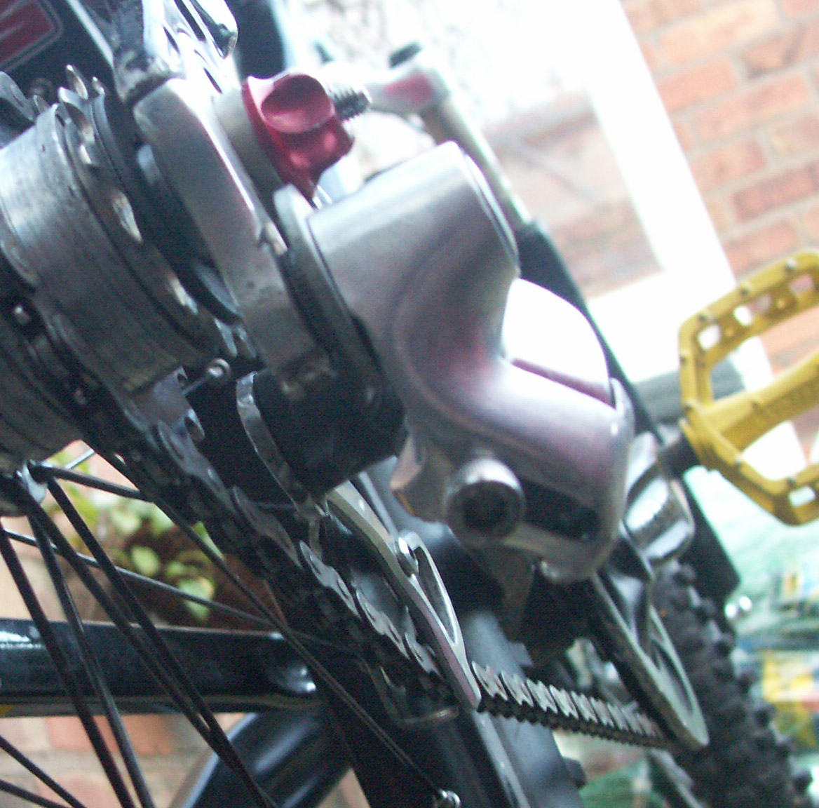

flower Posted March 22, 2006 Report Share Posted March 22, 2006 well basicly i cant run a cable in my rear mech any more due to the barral adjuster being smashed so iv moved the hi and low screws to there optimum place, but the chain line is still off a tad. Would a quick CHEAP and easy method to cut the main spring. Then it would float in its best position, or am i being stupid? help please. Quote Link to comment Share on other sites More sharing options...

MrSuave Posted March 22, 2006 Report Share Posted March 22, 2006 just drill out where the barrell adjuster used to be so that the outer cable just sits in that, drill bit is about 7mm if i remember. Quote Link to comment Share on other sites More sharing options...
dave33 Posted March 22, 2006 Report Share Posted March 22, 2006 remove the barrel adjuster and use a spoke instead of a cable Quote Link to comment Share on other sites More sharing options...
Krisboats Posted March 23, 2006 Report Share Posted March 23, 2006 (edited) Oh my god people. You'll need:A drill and a 5mm drill bitA bolt from somwhere like a stem, i think its an m5 threaded allen key boltAllen keycross head screwdriverAnd now you'll need to:Remove the high and low adjustment screwsget the drill with drill bit inserted and drill plugged inGet the drill and start drilling a roughly straight hole through the adjustment screw hole nearest the mech hanger, i think its the low adjustment screwdrill the hole out so its now a 5mm holeget the bolt and place it at the beginning of the holeinsert allen key into head of bolt and begin to twist it in, this will cut a thread into your freshly drilled holekeep going at it till you see the bolt starting to make an effect as it pushes against the adjustment tab in the mech, it will slowly and surely allow you to choose where abouts you want the mech to sit.if neccessary ease the bolt out and lube it up a bit to ease the thread cutting, or get a friend to take over for a bit... be careful though the bolt might have gotten a tad bit warm.Now you have a mech that can be accurately adjusted with a standard allen key no more chain skipping. Should look like the following attachment. This no means that the barrel adjuster tab is not needed so if you wanted to save weight/create a stronger landing point for misplaced sidehops you can angle grinder it off.EDIT: Just realised though that this will be making your mech single speed only, i got confused when dave said use a spoke. If your intending to use gears then mr tomnewbold is entriely correct, drill it out and use the barrel adjuster on the shifter to adjust the chain line. Edited March 23, 2006 by Krisboats Quote Link to comment Share on other sites More sharing options...
boon racoon Posted March 23, 2006 Report Share Posted March 23, 2006 (edited) easy as pietake out your gear cable and discard the outer. thread the cable through the normal hole so the nipple of the cable goes where the barrel adjuster usually is.tighten it up aligned in the correct gear and the mech will stay put. Edited March 23, 2006 by the boon Quote Link to comment Share on other sites More sharing options...
bones_dt4 Posted March 23, 2006 Report Share Posted March 23, 2006 hey there, if you manage to get the remains of the barrel adjuster out of the mech....fit another one, one off an old SIS mech are better because they are solid steel. (stronger)Then...get a piece of cable inner, cut to about 1-2 inches and poke it through and set the trials gear(normally top one) so that when the adjuster is out at the most that seems safe.YOU DONT HAVETO DO THIS IF U ONLY WANT ONE GEAR - in which case screw it in all the way.by doing this you can change down a few gears, always good when u haveto get about from place to place.hope this helps, ive never known anyone else to do it. Quote Link to comment Share on other sites More sharing options...
Caleb Posted March 23, 2006 Report Share Posted March 23, 2006 or drill to 4.2 and tap it properly? Quote Link to comment Share on other sites More sharing options...

flower Posted March 24, 2006 Author Report Share Posted March 24, 2006 or drill to 4.2 and tap it properly?I think il do that cheers, some of those replys seemed, well weird. Cheers anyway but if anyone knows how to make the chain stay in line without spokes, bolts, tapping or other weird shit, please say. Thaks for the quick replys people. Thanks Quote Link to comment Share on other sites More sharing options...
