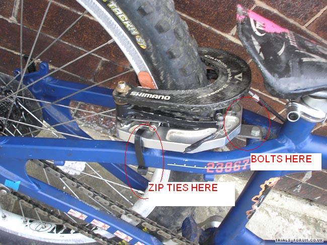

Brian Bleech Posted March 19, 2006 Report Share Posted March 19, 2006 I felt it deserved its owns topic rear brake set upMike Quote Link to comment Share on other sites More sharing options...

Endohopper Posted March 20, 2006 Report Share Posted March 20, 2006 She's a beaut , especially that rear brake setup , how exactly does the booster attatch to the frame ? Is that a RooX stem ? I used to love those . Quote Link to comment Share on other sites More sharing options...

Brian Bleech Posted March 20, 2006 Author Report Share Posted March 20, 2006 my leeson has cracked above the brake mount, so is been sent to clive this week for repair, respray and a few other bits Honestly it rides alright (Lewis preferred it to my leeson and Boon hated it, everyone else just laughed ) but i don't notice the low bb for street stuff (its relative anyway) plus i have 5mm extra spacers than my leeson and havea ton of cockpit room which helps. It decent on the back wheel and i could do pretty much everything i could do on my leeson and I did some new stuff. so ..yeh its all good as for the back brake, its a dna brake plate i stole off my crusier, held on with metal plate/bolts at top and zipties to stop moving side to side (ish) - gonna put jubelie clips instead of zipties though...[attachmentid=2880]oh yeah its a roox stem, fantastic stems really but dodgy colours headset i dodgy, bearings don't fit properly in cup. The tensioner is a mix of my leeson one and a dmr sts and the left hand crank kept coming loose for some reason um..thats it i thinkMike Quote Link to comment Share on other sites More sharing options...

Danny Posted March 20, 2006 Report Share Posted March 20, 2006 Considered drilling the backplate and bolting it straight to the 26" mounts? Much better than jubilee clips. Quote Link to comment Share on other sites More sharing options...
boon racoon Posted March 20, 2006 Report Share Posted March 20, 2006 Considered drilling the backplate and bolting it straight to the 26" mounts? Much better than jubilee clips.i believe he has, but couldn't get it to workmike i believe my exact words were "oh DEAR..no, no, no" but 'salrite if it means you can ride Quote Link to comment Share on other sites More sharing options...
