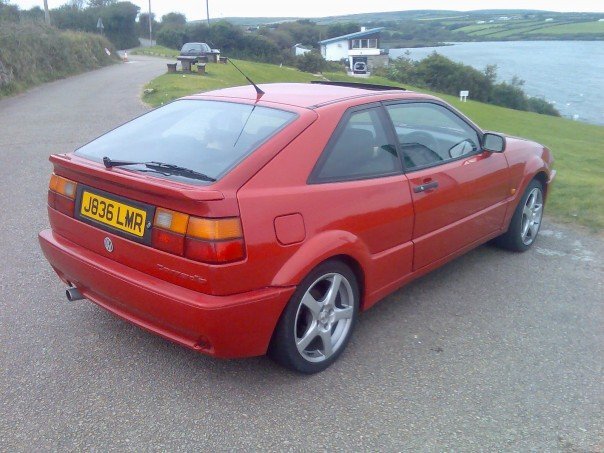

granty Posted November 7, 2007 Report Share Posted November 7, 2007 my mk2 golf 1800 driver gti cams, twin webbers, k&n filters, straight through stainless steel pipe. goes like shit off a shovel i can out do my brothers 1.8 gti 8v mk2 golf.this is my mates corrado only the 1.8 16v he got told it was the 2.0 16v even on the papers but he has got it changed on the papers back too the 1.8 but when he finds a 2.0 block he is gonna put that on. Quote Link to comment Share on other sites More sharing options...
