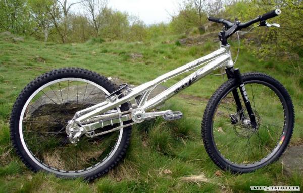

AdamR28 Posted February 2, 2005 Author Report Share Posted February 2, 2005 Would the toned down version use a stock or mod stem? I wondor what the highest bb rise that can be got with a normal stock stem? ← Well, it'd use a custom stem, like this one does. I reckon, since bar heights vary from around 37-41" (approx guess, in relation to the ground, on a 'normal' frame), you could have a 50mm (2") BB rise or drop, and it still feel 'normal' to a certain rider. However, people with low bars normally would be those with higher BBs (generally). I had a point... oh yeah, basically, i reckon anything more than 20mm BB rise needs a different stem. Quote Link to comment Share on other sites More sharing options...

AdamR28 Posted February 7, 2005 Author Report Share Posted February 7, 2005 Just a little pic i knocked together and a small update: http://www.tartybikes.trials-shack.co.uk/t...ecomparison.jpg It appears (from trying to fit my old forks yesterday) that the reason for the higher bars (15mm higher) on the proto frame is that its head tube is 15mm longer! Other than that, the wheelbase is a smidge longer, the top tube appears to follow a higher line, and the reach is a tad longer. I had a bit of a (street) ride last night, and quite enjoyed it. As expected, even with 400g heavier forks than im used to, it sits on the back wheel very nicely. As Ben said, sidehopping appears easier, and I also got the hang of backwheeling quite quickly. Gapping/upping to front wheel is very very nice, the high BB puts you more over the front axle and the bike seems to just float up! Back wheel gapping is very strange at first - the bike feels very light due to it wanting to fire the back end through, but with a small change in technique (not as much pedalling force and more body movement) I could gap as far as on my standard Rex. Next up - natural, where im expecting it to shine :( Quote Link to comment Share on other sites More sharing options...
Brisa Posted February 7, 2005 Report Share Posted February 7, 2005 Adam, know this will probably be more hassle than worth but I personally would love to see one person riding both a t-rex and the proto frame on same types of terrain, same moves in the same sort of time frame to rule out progression Quote Link to comment Share on other sites More sharing options...
AdamR28 Posted February 14, 2005 Author Report Share Posted February 14, 2005 Adam, know this will probably be more hassle than worth but I personally would love to see one person riding both a t-rex and the proto frame on same types of terrain, same moves in the same sort of time frame to rule out progression ← I was thinking about this... and it'd be quite tricky. It takes a long time to get used to the new frame, since its so different - might even be classed as progress! :P Will bear it in mind though :P Cheers. Took a few 'comparison' style vids yesterday - myself on the proto, and Dave on his standard T-Rex... should be online tonight. Was a nice chilled ride on some rocks... and all I have to say is: Anyone wanna buy my T-Rex frame? :P Quote Link to comment Share on other sites More sharing options...
