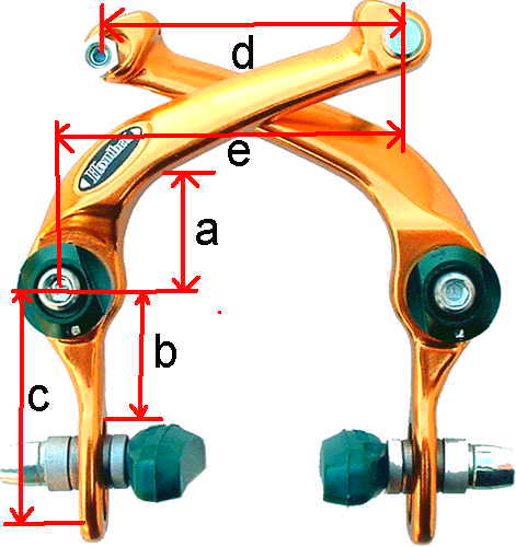

Brian Bleech Posted November 14, 2006 Report Share Posted November 14, 2006 Could someone do me a favour and measure the distance between the middle of the pad bit to the mounts on a hombre and evolver brake please any U-brake would do to start with, but would like one of those two really thanks Quote Link to comment Share on other sites More sharing options...
Mark W Posted November 14, 2006 Report Share Posted November 14, 2006 I've got my Hombre arms lying on the table next to me, so if you're a bit more specific of what you want from where, I'll sort ye out. Quote Link to comment Share on other sites More sharing options...
Brian Bleech Posted November 14, 2006 Report Share Posted November 14, 2006 I've got my Hombre arms lying on the table next to me, so if you're a bit more specific of what you want from where, I'll sort ye out.cool, yeah I was a bit vague. Thinking about it a couple more would be useful toopaint diagram coming up rightio - also does anyone know what the minimum distance 'd' can be for a front brake[attachmentid=8162]yeah this might be for the 24" just need rough ideas too see if it worth trying Quote Link to comment Share on other sites More sharing options...
Mark W Posted November 14, 2006 Report Share Posted November 14, 2006 If it's for a front brake, go to G-Sport's site and check out his front brake. I'm hearing more and more people running them and saying they're good, and it's a shitload easier routing the front brake cable in the way he does it... www.gsportbmx.co.uk Quote Link to comment Share on other sites More sharing options...
Brian Bleech Posted November 15, 2006 Report Share Posted November 15, 2006 If it's for a front brake, go to G-Sport's site and check out his front brake. I'm hearing more and more people running them and saying they're good, and it's a shitload easier routing the front brake cable in the way he does it... www.gsportbmx.co.ukI have had a look but can't see anything, could you point me in the right direction - is it the same that was in Ride last month or so? Quote Link to comment Share on other sites More sharing options...

Brian Bleech Posted November 16, 2006 Report Share Posted November 16, 2006 Heres the link. Scroll down a bit to see a clear picture.thanks dude - i was looking on the new site If it's for a front brake, go to G-Sport's site and check out his front brake. I'm hearing more and more people running them and saying they're good, and it's a shitload easier routing the front brake cable in the way he does it... www.gsportbmx.co.ukso I would have to go back to canti's! I had a real problem with snapping straddle cables back int day. I wonder is I use a london mod on the front :wizard: But the avid shorty is a sweet brake and I could use vee pads! I would have to find a way stop the outer cable at the top too, but the routing looks ace Quote Link to comment Share on other sites More sharing options...
poopipe Posted November 16, 2006 Report Share Posted November 16, 2006 if you're worried about running v's on the front with regard to barspins etc. then don't...I used to run a standard sized dia-compe V on the front of my bmx with a gyro years ago and had no trouble at all with clearance. You just to turn the noodle upside down, bend it a bit and route the cable through the steerer tube as you would with a U brake. it worked fine for me Quote Link to comment Share on other sites More sharing options...
Brian Bleech Posted November 16, 2006 Report Share Posted November 16, 2006 if you're worried about running v's on the front with regard to barspins etc. then don't...I used to run a standard sized dia-compe V on the front of my bmx with a gyro years ago and had no trouble at all with clearance. You just to turn the noodle upside down, bend it a bit and route the cable through the steerer tube as you would with a U brake. it worked fine for meyeah I used to run a deore one, but could never get it quite right! Always felt a bit crap! May try again...may as well get a whole new front brake if I do that too, my current one is pretty buggeredI did run a cane creek vee which has no noodle and that felt good, but broke in a couple of months because they were pretty shitty quality, expecially the springs....plus I wouldn't mind running/trying something different just because..i suppose i could run the same setup but with a U-brake Quote Link to comment Share on other sites More sharing options...
