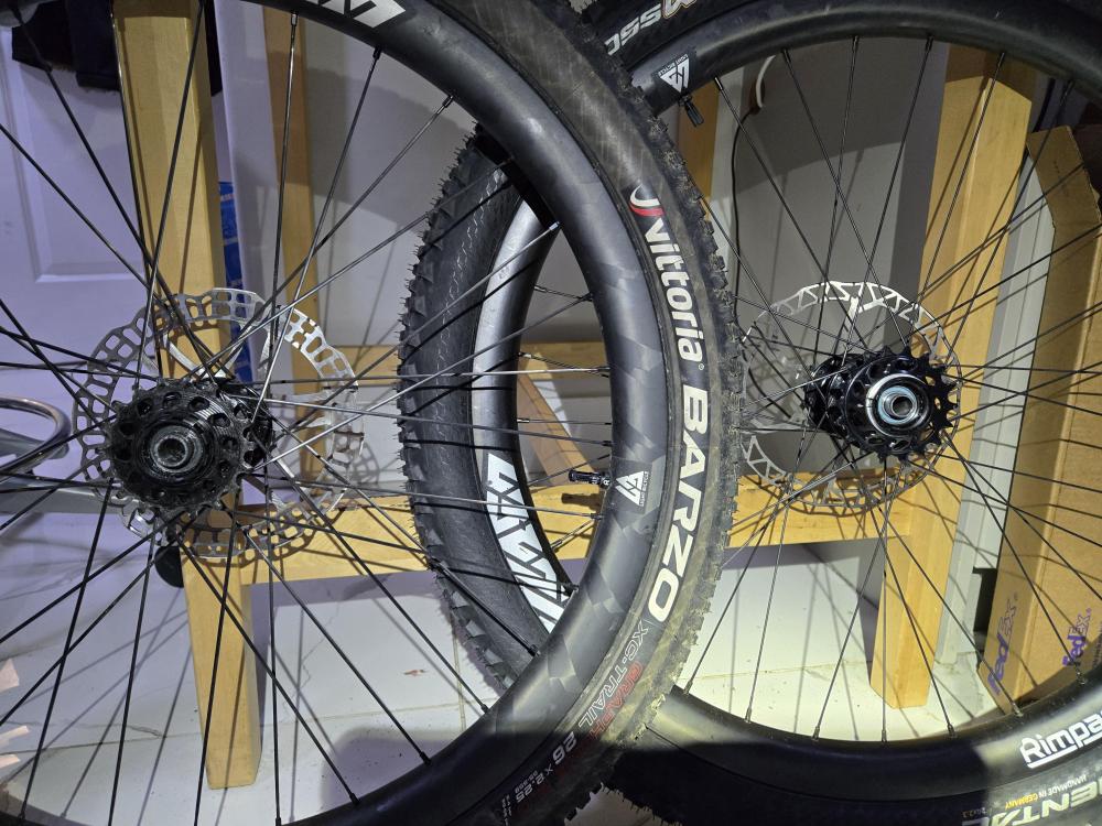

Sam Song Posted January 20 Report Share Posted January 20 (edited) I bought a spare Industry Nine Hydra wheel from local Facebook marketplace with the following specs: - Hydra rear classic 142mm thruaxle. I figured i could make use of this rear wheel by swapping the 135 through axle endcaps from my rear Singlespeed Hydra that fits on my Hex. As it turns out, the end cap from my singlespeed Hydra does not fit over what appears to be a smaller axle on the new Hydra classic 142 through axle hub i bought. The endcap will wiggle over it. You can see that the Singlespeed axle on the left has a larger diameter What axle do I need to make my non boost classic Hydra work on the Hex? Industry Nine sells 135 x 12 endcaps but it does not specify whether it is for Singlespeed rear or Non-boost classic rear. Edited January 20 by Sam Song Quote Link to comment Share on other sites More sharing options...
