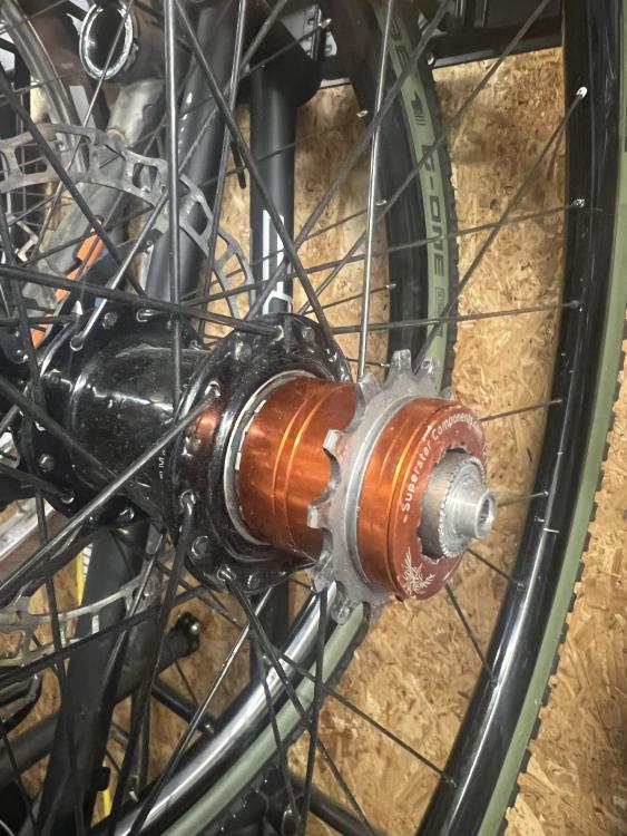

grant wildman Posted November 28, 2024 Report Share Posted November 28, 2024 Never had an issue with fitting single speed spacers to any of my king hubs… Most SS spacers don’t have a spines anymore either. Not to teach you to suck eggs, but use the widest base sprocket you can as the alloy freehub on king hubs is soft, it will dig in. steel freehub/drive shells are hard to come by. Torquingthe lock ring to 40nm should help reduce this. 1 Quote Link to comment Share on other sites More sharing options...
grant wildman Posted November 28, 2024 Report Share Posted November 28, 2024 Sorry for the bad picture, but here’s one of my ISO hubs with a cheap Superstar SS spacer kit fitted. Quote Link to comment Share on other sites More sharing options...
Brettoll Posted November 29, 2024 Author Report Share Posted November 29, 2024 (edited) On 11/28/2024 at 6:27 PM, grant wildman said: Never had an issue with fitting single speed spacers to any of my king hubs… Most SS spacers don’t have a spines anymore either. Not to teach you to suck eggs, but use the widest base sprocket you can as the alloy freehub on king hubs is soft, it will dig in. steel freehub/drive shells are hard to come by. Torquingthe lock ring to 40nm should help reduce this. Expand Thank you for that Grant, attempted to pop a set I had lying around - think it's a Halo one, but just not having it. Have a wide sprocket that is a given as remember them being soft! Will have a look and find something similar to the Superstar as they don't produce them anymore. Edited November 29, 2024 by Brettoll Quote Link to comment Share on other sites More sharing options...
monkeyseemonkeydo Posted November 29, 2024 Report Share Posted November 29, 2024 It's not just damage to the drive splines causing problems is it? I've had it before where the internal clearance on the spacers is minimal and a little filing of any burrs on the drive shell has made all the difference to getting them to fit. 1 Quote Link to comment Share on other sites More sharing options...
Brettoll Posted November 29, 2024 Author Report Share Posted November 29, 2024 On 11/29/2024 at 12:00 PM, monkeyseemonkeydo said: It's not just damage to the drive splines causing problems is it? I've had it before where the internal clearance on the spacers is minimal and a little filing of any burrs on the drive shell has made all the difference to getting them to fit. Expand A worthy point as well, the splines are worn but not horrific and I can get a splined single speed sprocket on it - just seems the diameter is out a mm or so for the spacers 1 Quote Link to comment Share on other sites More sharing options...
