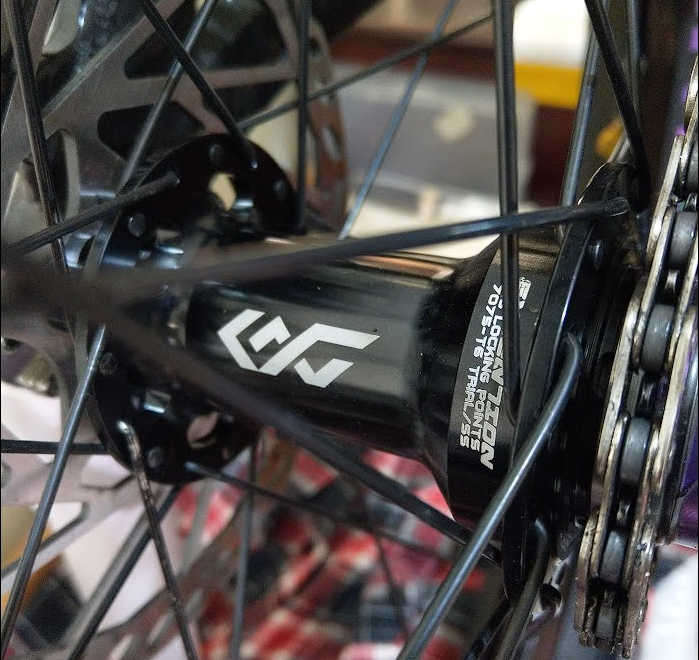

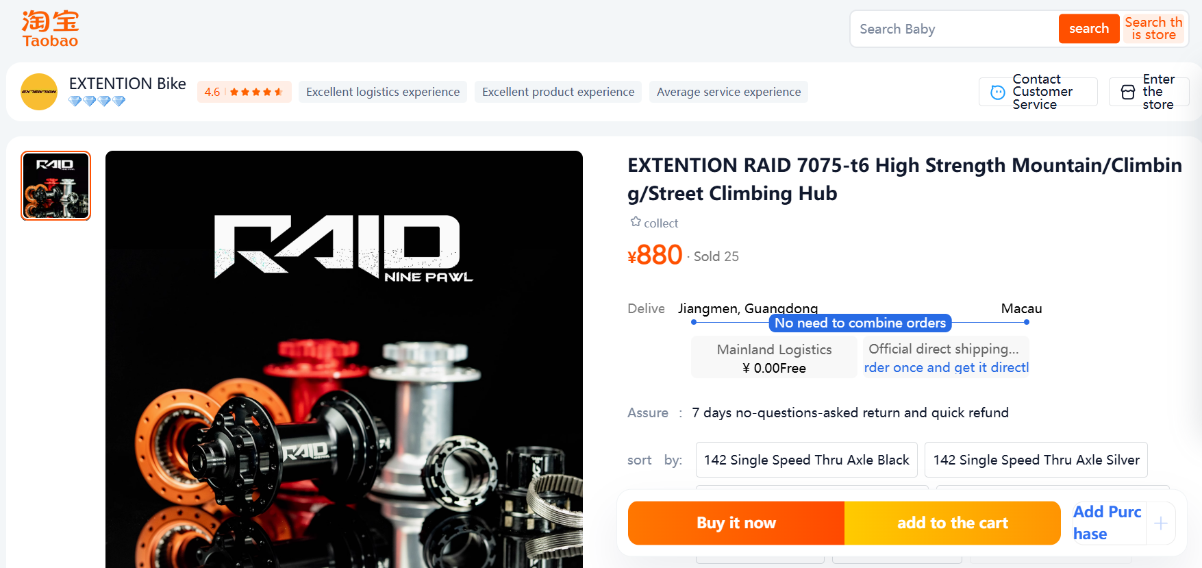

craigjames Posted yesterday at 10:25 AM Report Share Posted yesterday at 10:25 AM I saw these when i was looking for a rear freehub, fingers crossed it works all ok for you. I wasn't brave enough to try it and went for a Hope Pro5 😁 Can i ask, where you got it from and how much it cost? There isn't loads of information available online. 1 Quote Link to comment Share on other sites More sharing options...
Szymon Posted yesterday at 11:14 AM Report Share Posted yesterday at 11:14 AM The hub looks good. Also inside. I wouldn't be afraid. Quote Link to comment Share on other sites More sharing options...
MaderaMark Posted yesterday at 11:18 AM Author Report Share Posted yesterday at 11:18 AM bought from Taobao, I am currently working in Macau. There should be Extention Dealers in Europe. Or try in their instagram page https://www.instagram.com/p/CxkoKrdBDvt/?img_index=1 Quote Link to comment Share on other sites More sharing options...
MaderaMark Posted yesterday at 11:19 AM Author Report Share Posted yesterday at 11:19 AM https://www.instagram.com/p/CxhoOykBsTF/ Quote Link to comment Share on other sites More sharing options...
Daan Posted yesterday at 06:29 PM Report Share Posted yesterday at 06:29 PM (edited) € 145 at trialmarkt.de. Looks alright, 9 pawls, offset so 3 engage on a 42 tooth ring, so 126 engagement points. Too bad there's no 135 mm bolt on option it seems, only 12x142? Let us know how you get on with it! Edited yesterday at 06:32 PM by Daan Quote Link to comment Share on other sites More sharing options...
MaderaMark Posted 18 hours ago Author Report Share Posted 18 hours ago 9 hours ago, Daan said: € 145 at trialmarkt.de. Looks alright, 9 pawls, offset so 3 engage on a 42 tooth ring, so 126 engagement points. Too bad there's no 135 mm bolt on option it seems, only 12x142? Let us know how you get on with it! there should be, I got this 135 x 10 bolt-on.... besides there are ways to convert those just like the other hubs.... 1 Quote Link to comment Share on other sites More sharing options...
MaderaMark Posted 17 hours ago Author Report Share Posted 17 hours ago What I am after as well is the material used. As of 7075 T6 for the shell, that should be tougher than 6061 (hopefully I am correct). Quote Link to comment Share on other sites More sharing options...
La Bourde Posted 15 hours ago Report Share Posted 15 hours ago (edited) The alloy used can make a difference, but unfortunately, that does not tell us how well they are produced. Tolerances are a big deal on a hub. Time will tell. Edited 15 hours ago by La Bourde 1 Quote Link to comment Share on other sites More sharing options...
SergeL Posted 12 hours ago Report Share Posted 12 hours ago If driver body is aluminum, then pawls' sockets look a bit thin. I've seen other hubs, where it was slightly bent inward from pedalkicks, thus making bearing unevenly squeezed. 1 Quote Link to comment Share on other sites More sharing options...
MaderaMark Posted 11 hours ago Author Report Share Posted 11 hours ago this will eventually test my faith..... riding happy or ended with broken teeth...... 2 Hope pro4 passed away and was much worried when that happened on a relatively gap with snakes in between.... Quote Link to comment Share on other sites More sharing options...
