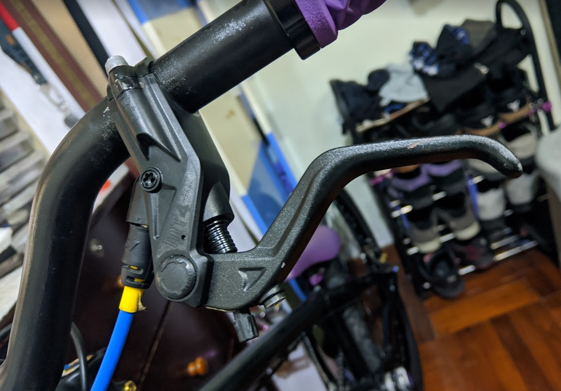

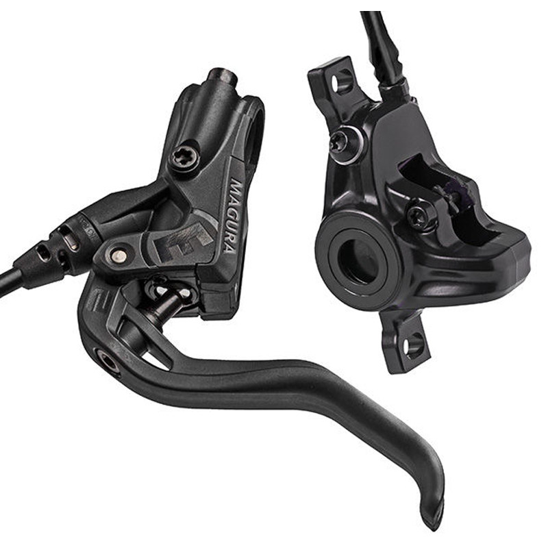

MaderaMark Posted September 27, 2024 Report Share Posted September 27, 2024 I am currently using the classic MT2/MT4 (BAT) levers and it felt so good due to its long lever blade compared to my shigura. Few days ago I started to see some oil leak near the clamp and started to prepare before the worst happens. I was thinking if I go with this MTSix, some parts of my old levers will be compatible (hopefully) or move on to new versions? Cheers! Quote Link to comment Share on other sites More sharing options...
Szymon Posted September 27, 2024 Report Share Posted September 27, 2024 These brake levers are completely different. The old one looks more like the new HS33. https://www.ebay.pl/itm/205008770703?_skw=magura+mt4&itmmeta=01J8S2P9TEZED6MMC6TCM542C4&hash=item2fbb79968f:g:EA8AAOSwB2pjljSm&itmprp=enc%3AAQAJAAAA4HoV3kP08IDx%2BKZ9MfhVJKkDLHzZkGnRfwsQL9MOz3nFzhRRPlnDzFmR2P4193CJ2UiLZ3Zwx52bd1P5z7vqobZtNT9NJ9%2F7%2FB4qSVSQqFVbbIsUNh9XPqCPrkjbV%2FnCci2XLbRJT91j%2BXlMr7joNURfeAyB4%2BLZWTkJcTioNwlkHJ7RDFjQmX4YAx3JuPRJXK%2Bwq2jXytiD06pej9TB2B3xrTlXkELV28wkMiZQvE0Y2RmtxQ9Tw39FFY5LD1UAEi9WTJ%2BSbvDeF5xZrzHhhlsnmRB4yfHsyOAzewBD9VVd|tkp%3ABk9SR6id2aLGZA Quote Link to comment Share on other sites More sharing options...
MaderaMark Posted September 28, 2024 Author Report Share Posted September 28, 2024 This is what I currently use. Though due to aging, some parts were already started to show oil leaks. Anyone can suggest, performance wise and some reliability.... Quote Link to comment Share on other sites More sharing options...

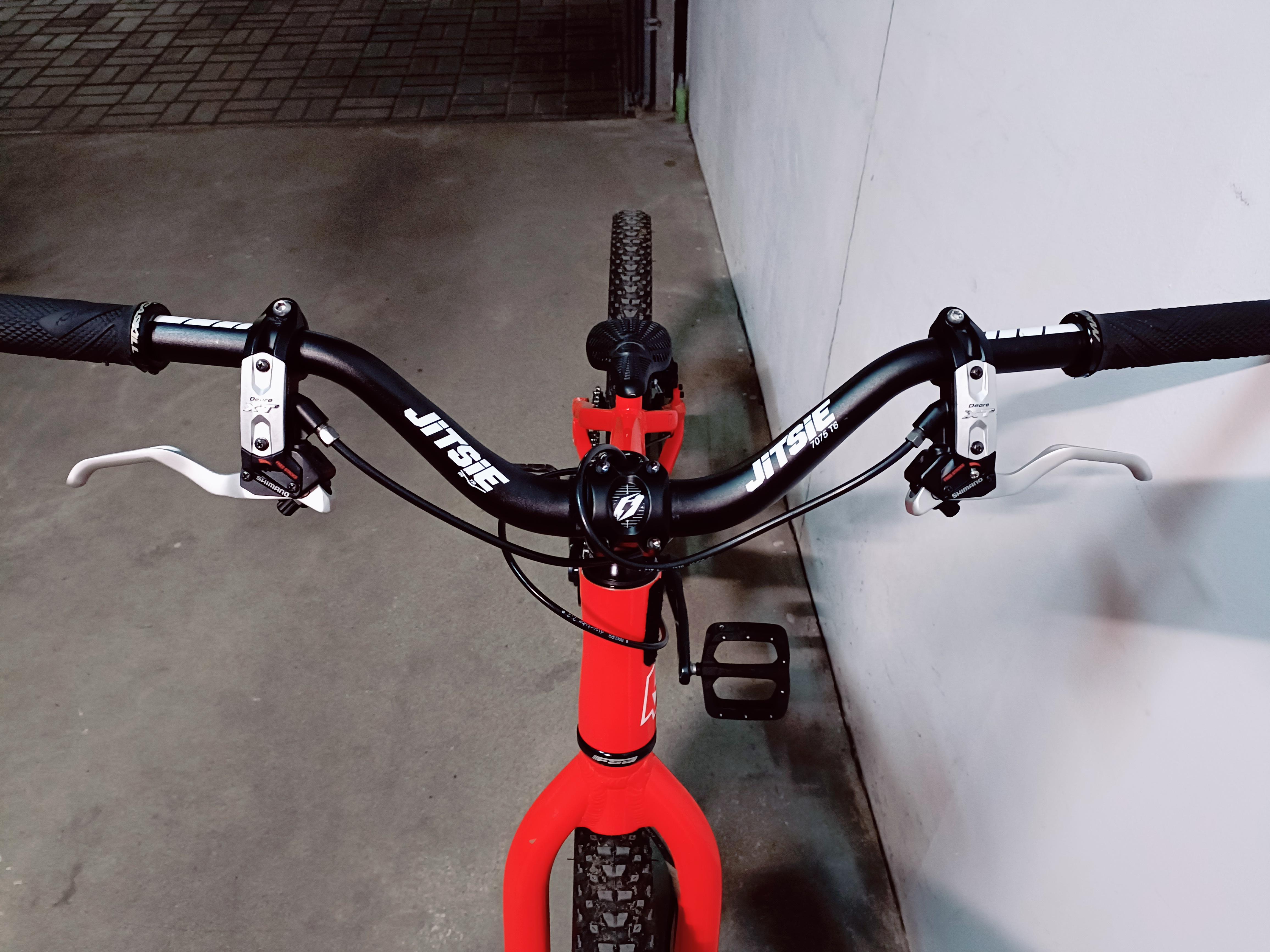

Daan Posted September 29, 2024 Report Share Posted September 29, 2024 (edited) Have a look at the Shimano M4100 lever, it's also got a very long lever blade. No servo wave, and slightly smaller MC diameter than Magura, so should give a similar feel with perhaps slightly more power. Only thing is it needs even more room than the Magura lever to set up for one finger braking. I personally couldn't use them with an Inspired Arcade bar (these have quite a short grip section) because of this, couldn't move them far enough inboard. Ymmv with other bars, yours looks like it might just work. Edited September 29, 2024 by Daan 1 Quote Link to comment Share on other sites More sharing options...
