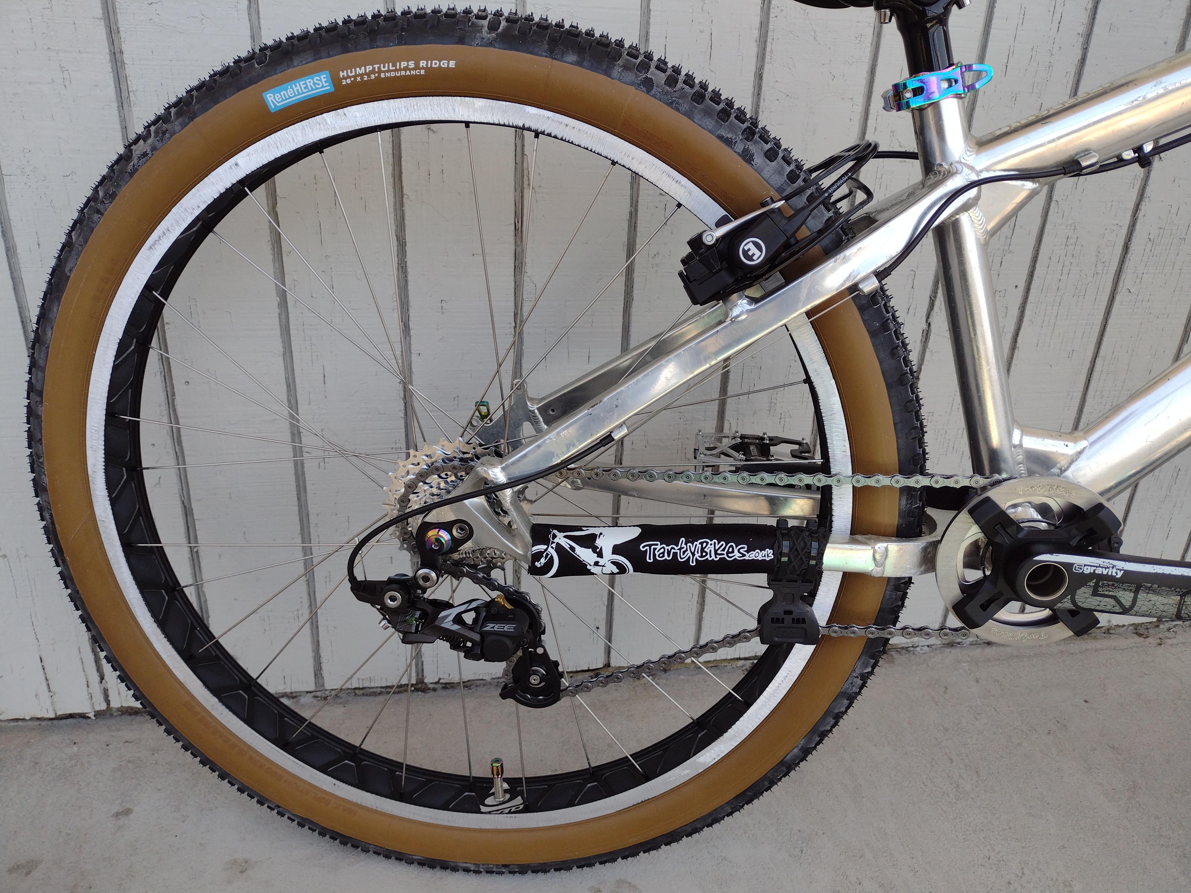

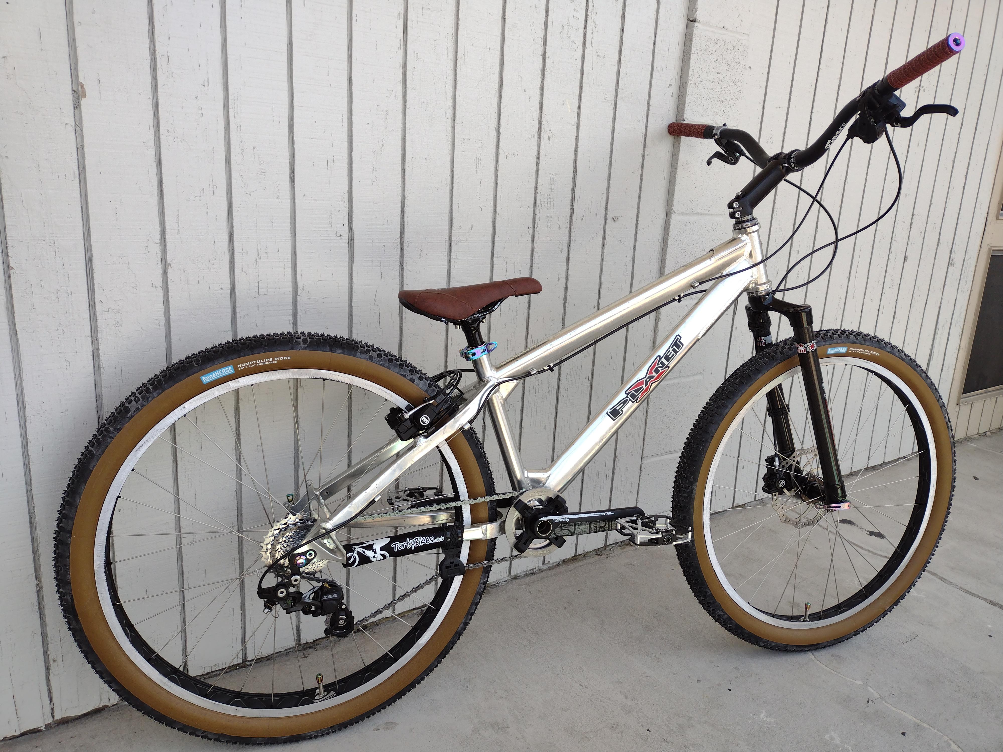

Picked up a polished Mk2 with a load of mismatched parts slapped on. While going through the process of planning the build up, I eventually realized that a lot of the things that were standard cross country bikes parts in the 90's are now considered gravel bike components. And Planet X now only sells road and adventure bikes. So it seemed appropriate to make fun of that a bit. I'm stoked with how it turned out, and that I get to confuse a few of the roadie types the next time I visit a couple of my local shops. 😂
Frame: Planet X Zebdi Mk2.
Fork: Whyte brothers "rock solid" 445mm carbon

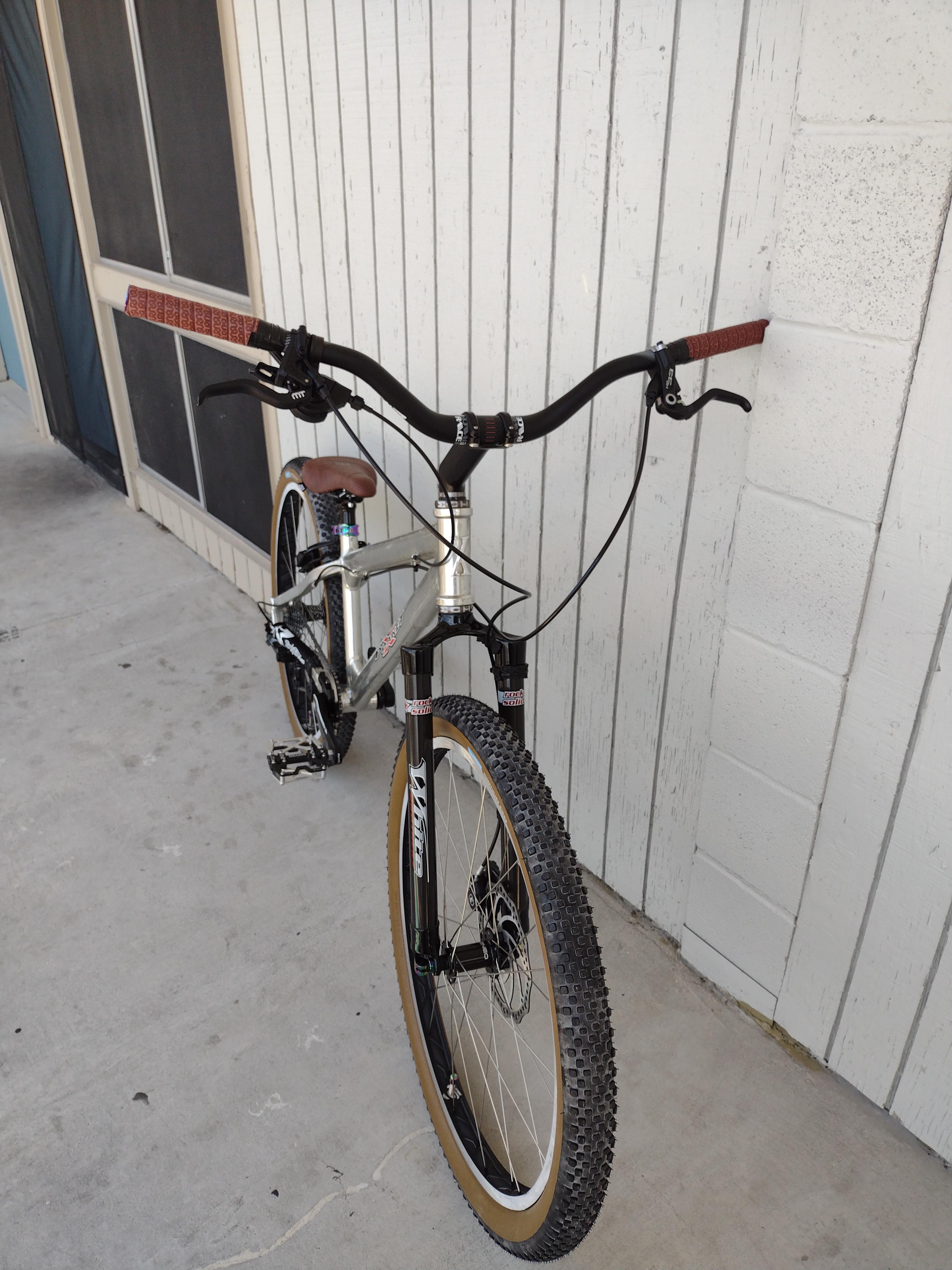

Cockpit:
Headset- Echo
Stem- Clean 125mm 25deg
Bars- Monty ProRace carbon
Saddle- Title JS1 cro-mo leather
Seatpost- Zero offset Carbon from Amazon
Grips- Bar Tape

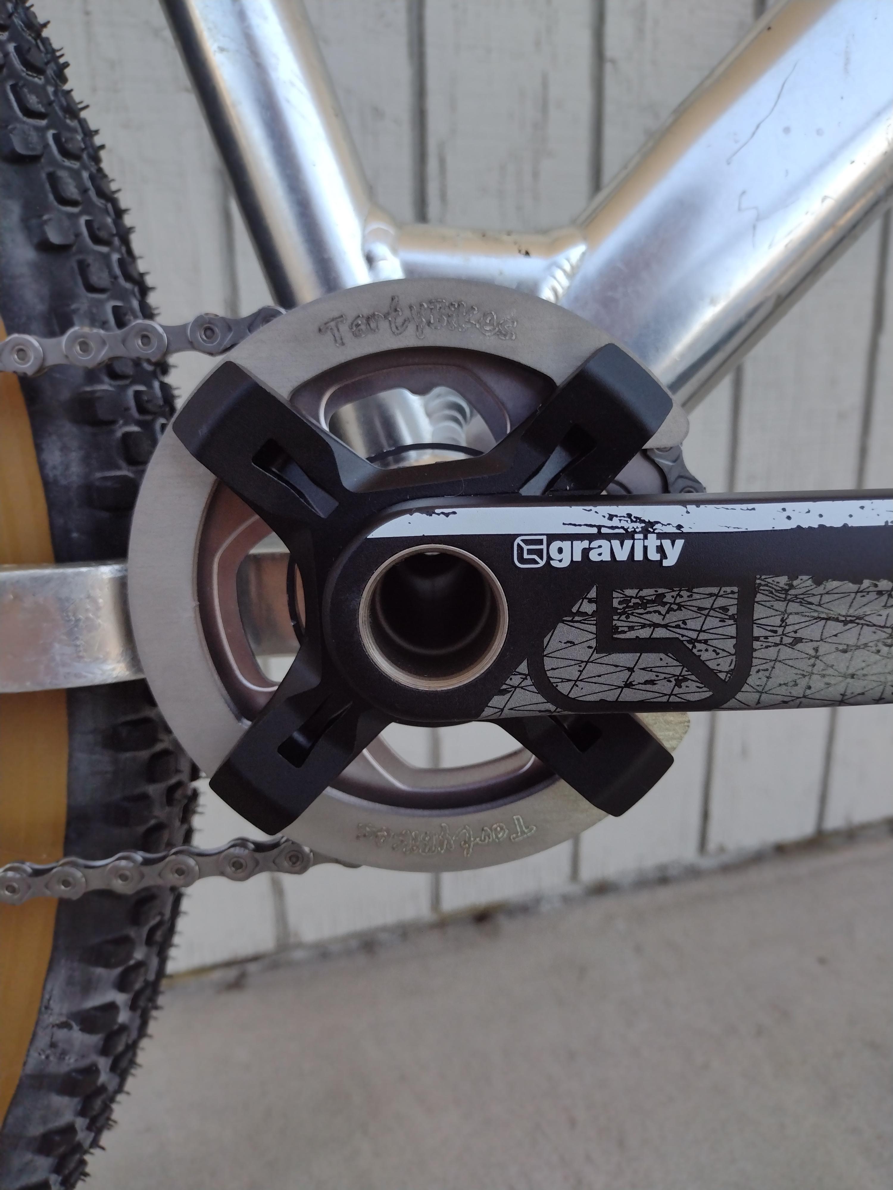

Crank set- FSA Gravity grid, Tarty Bikes Rock ring, 28 tooth 64mm Shimano chain ring,
KmC x10 chain
Cassette- Microshift 10spd 11-28
Derailer- Shimano ZEE DH
Shifter- Shimano ZEE 10spd
(D.C.D style chain tensioner)
Absolutely zero chain noises. Where was this set up in 1999? 😂

Tires- Rene HERSE Humptulips Ridge 26x2.3 Endurance casing
Ali express Tanke brand oil slick bar ends, valve caps, skewer's and seat post clamp.
I dub this steed, the Gravel Trials.
