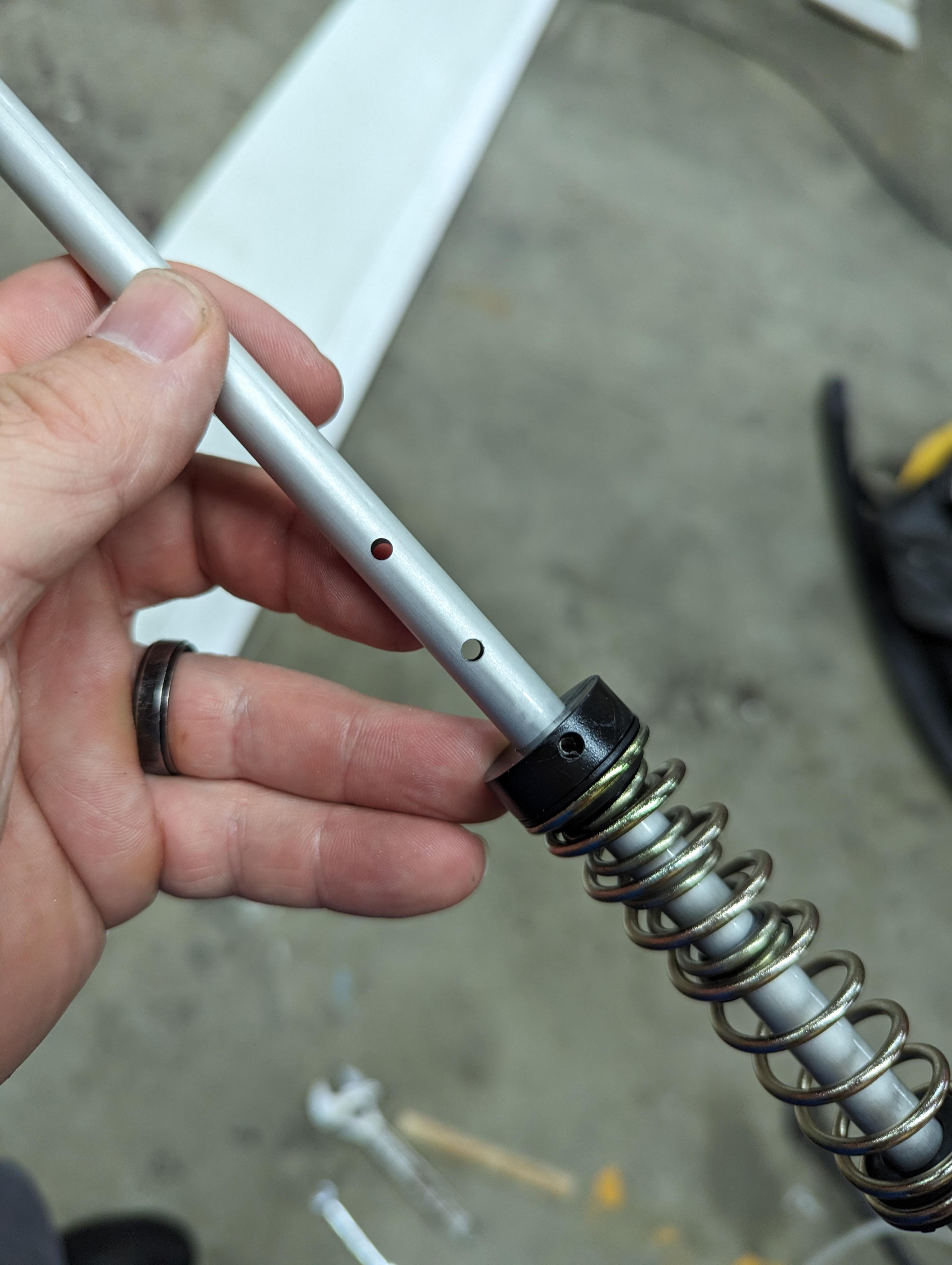

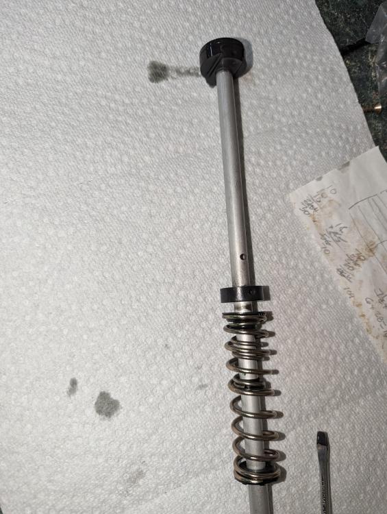

cwtrials Posted July 6, 2024 Author Report Share Posted July 6, 2024 (edited) Ok, I think I made it work. This old fox F80RLT has a pin that holds the top out plate. Instead of spacers you move the top out plate by tapping out the pin, which allows it to slide to different locations. The shaft comes with two preset holes drilled, one for 80mm and another for 100mm. You can see the hole to the left would allow for increasing travel to 100mm. I'm order to decrease travel I had to drill another hole in the shaft. Should be about 60mm travel now. Axle to crown around 445. Edited July 7, 2024 by cwtrials 1 Quote Link to comment Share on other sites More sharing options...

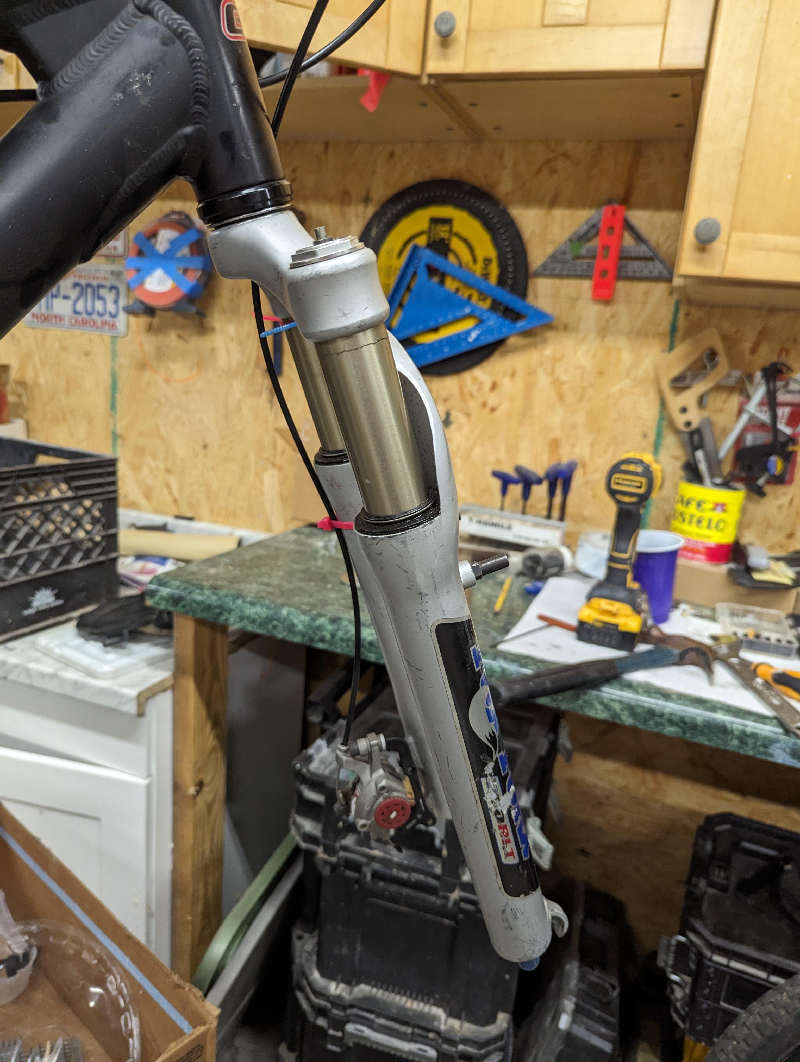

cwtrials Posted July 7, 2024 Author Report Share Posted July 7, 2024 Built it up today. 1 1 Quote Link to comment Share on other sites More sharing options...
