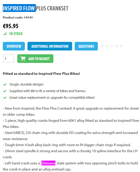

Bakeiro Posted May 8, 2024 Author Report Share Posted May 8, 2024 But I think it's true that the truvaliv crankset isn't compatible, because when I look at the page of the inspired flow crankset says that uses the 'Shimano style' (image attached) also when I look at the truvaliv crankset says that is compatible with inspired hex and fourplay, but doesn't mention inspired flow Quote Link to comment Share on other sites More sharing options...
Daan Posted May 8, 2024 Report Share Posted May 8, 2024 Dude, you're getting things mixed up. You have a crank (the thing with the big axle and arms where you attach the chainring and pedals to) and a bottom bracket (the cups with bearings that go into the frame). Shimano cranks use a 24 mm axle, DUB a 28.99 mm one, so the bottom brackets are different. So just replace the Shimano bottom bracket on your bike with the DUB bottom bracket that came with the crank (at least the one in your link came with a bottom bracket) and you're good to go. Quote Link to comment Share on other sites More sharing options...

La Bourde Posted May 8, 2024 Report Share Posted May 8, 2024 Dub is the axle standard. The axle has a diameter of 28.99 as pointed out by Daan. But they are several bottom bracket shells: BSA, pf30, etc. For your inspired you need a dub BSA bottom bracket. Quote Link to comment Share on other sites More sharing options...
